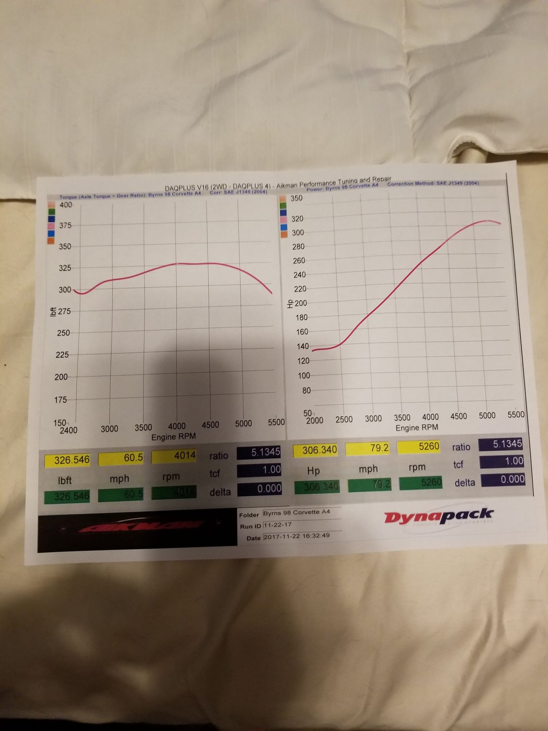

I got the sameones on my 98 auto. I love them. The install was super easy on drivers side i had to remove valve cover to get them to fit. I have heard horror stories on long tube install. From cutting oil pan and lifting engine.
Here is my dyno tune. I have a modify airbox, bypass muffler and xpipe.
