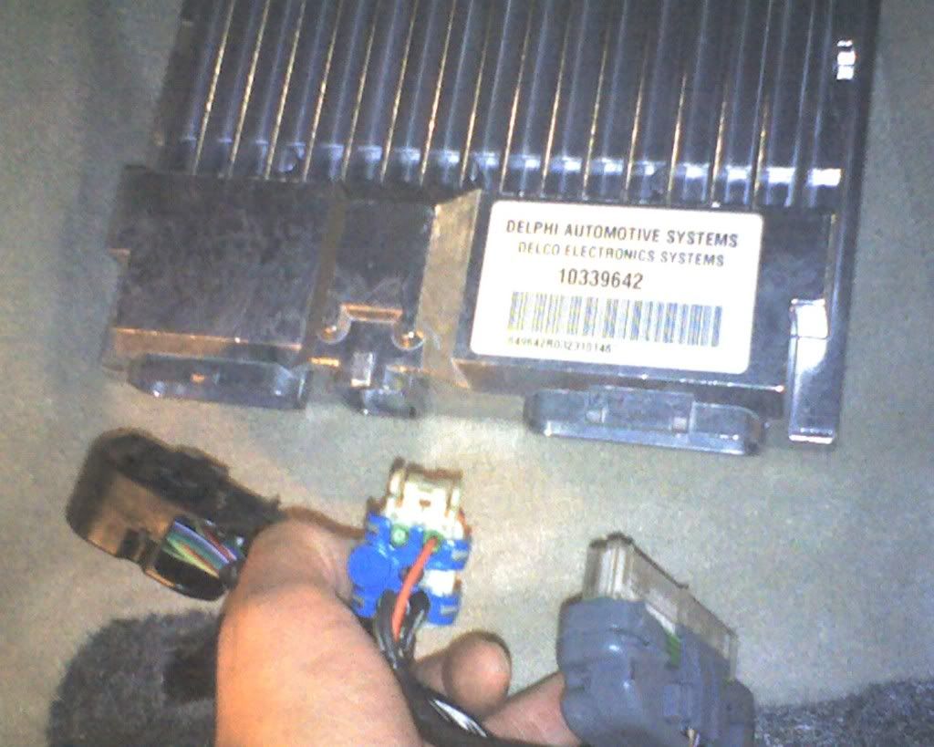

Old Jun 27, 2008 | 06:05 PM
Mojo's Avatar
Mojo
Joined: May 1999
Posts: 3,588
From: Volcano, HI
Here's a pic of the module.

Old Jun 27, 2008 | 06:48 PM
BlackZ06's Avatar
BlackZ06
Joined: Aug 2000
Posts: 4,933
Likes: 30
From: San Rafael CA
Nothing in the schematics that Bill Curlee posted shows a TCS connection .... nor is there anything in the F45 system either. Only wire between the F45 and the EBCM is the EBCM (which runs the TCS software) reports the output from the Steering Wheel Position Sensor to the ECS (Electronic Suspension Controller). Disconnecting that makes no difference in the F45 system.
What specific error was being reported when you pulled the cables off the ECS ???? was it a DTC, or were you using the DIC and it was reporting NO COMM with the TCS module ???? I'll PM Bill Curlee and have him look in his F55 specific manual at the wires that the connectors carry to the ESC ..... makes no sense to me why the loss of the ESC should affect the EBCM .... worst case if the EBCM was receiving data from the ESC you'd expect a DTC ... if the EBCM noticed the ESC was gone (not sending SOH messages) then you'd expect a Uxxxx "loss of comms" message ... which is no big deal. Modules post Uxxxx messages all the time.
Let me know EXACTLY what error message you were seeing .... I'll PM Bill to get more data .....
