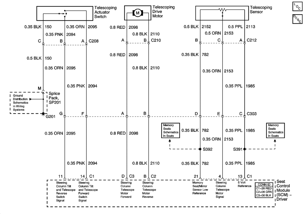

OK here is what i have found so far.
When i unplug the telescopic sensor, the button moves the steering wheel in and out with no problems, once i connect it again, the button works sometimes and not others,
When i get the switch working I can read the resistance on a multimeter showing that the telescopic sensor seems to be working, so maybe I will check if there is dry joints in the seat control module

Replaced the Driver Seat Control Module and the fault is exactly the same
When i press the memory the seat moves and the mirrors radio and everything else, BUT the Telescopic Steering does NOT.
Might try a adjustable pot to see if i can trick the bcu into thinking it has a location.
Running out of ideas, the recalibrate of the telescopic doesnt work, when you move the telescopic manually it moves 1-2 inches and you have to keep pressing the button to get it to move.
However if i unplug the telescopic sensor it moves all the way in and out without pausing

Maybe the sensor is bad ? Since when you remove it everything works.

It sounds like the position feedback circuit isn't connecting to the SCM. I no longer have the manuals needed to post pictures or schematics but that feedback system may be part of the motor itself. I'm truly not sure. Maybe forum member DeeGee has a diagram or Bill Curlee.

OK finally fixed
Tried a new SCM same problem
In the end i removed the telescopic sensor and activated it manually, seemed to work forward and back but was not working properly, meaning i set a memory and then test it and it would move but not to the correct memory location.
I spotted the black wire was cut, not all the way through but based on the fact it is a resistance curcuit it could have caused a problem.
I redid the connections and retested it, after setting the calibibration it worked but when the key was removed the column moved out not in, an the button also worked reverse.
I swapped the motor wires around and everything works fine now.
As it is a converted car from left to RHD, when the mechanic changed the steering sensor recently it appears he put the wires on the motor backwards.
