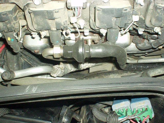

My cure for right side check valve.

I hate that damn valve, it is buried behind the intake manifold. I've already replaced mine 2 or 3x and yes you gotta move the intake manifold to get to it. I've replaced the drivers side (the P1415) valve only once and that one is literally a 2 minute job. Some claim they can pull it out without touching the intake manifold but I don't see how that's possible.
You can- try to force some penetrating oil up the AIR tube with compressed air, by in my experience the fix is short lived.

Had that problem on my 01, I used Bill Curlee's thread but used carburetor cleaner instead of WD-40. Once you fill the hose leading to the RS valve, let it sit for half an hour or so, then put the air hose to it.
I did this a couple of years ago, haven't had the problem since.
