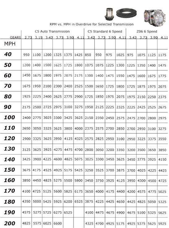

Check this out:
I have done gear work before. I swapped out my 4.10's in my Dana 60 for a set of 4.88's and it took a lot of time... even with the right tools.
The C5 rear end is a different animal all together. It requires a special tool kit that costs about a grand, if memory serves correctly. It's not something that your average enthusiast would want to tackle. Hell, it's not something that your local dealer or even an experienced mechanic would want to deal with.
More often than not, you trust that work to the Pros that are experienced in that unit. DTE has been mentioned, and they have a great reputation. I'm sure there are others if you look around a bit.
As you can see in the chart, a 3.42 with an auto is a good choice for a car that is driven around town and on the highway. If you are going to go racing, then a 3.73 or deeper gearset will get you gobs of acceleration... but highway manners may suffer. (As would your gas mileage... but who cares if you are focused on speed? )
