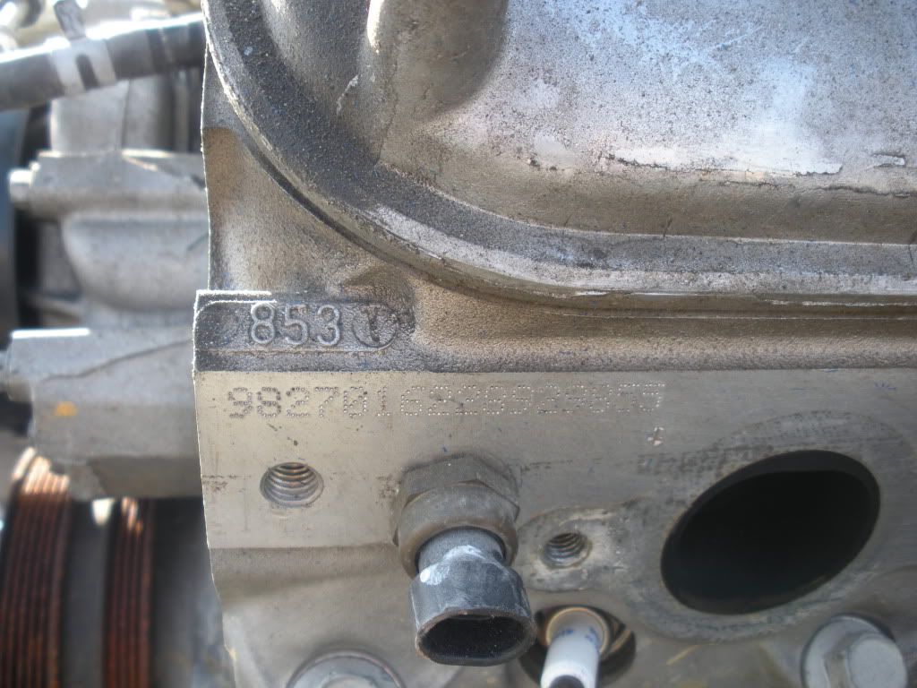

I purchased this motor in a wreck I purchased for a GTM project.
It had lots of mods, Coilovers, Headers, Shifter ETC.
It also had an oil cooler, and these heads on it.
It says DRM 030 on it. I contacted DRM and they said that is how much they shaved off the deck to increase the compression.
I cant tell if they were stock heads and they were just Modded this way?
Is that something you have done by its self, or usually with porting or Cam or what else? Car also had an LS6 intake (originally came with an LS1 as it was a 2000) and a BBK TB.
Any idea what this setup would make? Assume headers and a good tune, Approximate?
I know a great deal about these cars, but I went the FI route when modding mine, so Heads and Cam stuff is a bit beyond me.

How about a pic of the heads?
they should have a casting number on the aft part near where the valve cover meets the head. 241, 243, 799, etc.
If they were a brand (AFR, TFS,)it would likely say it on the front face of the head.

Wow, I totally posted the wrong pictures... My bust. I f'd something up with PB

Early style LS1 heads. good for boat ancors.
People have been known to make big power out of stock 243 casting heads found on the C5 Z06.
You should be able to find a pair for around $400-$500 used.

853's are the early LS1 castings. They are the "worst" of the LSx castings. You would probably have to pull the heads and valve covers to see if anything else was done. I don't know if someone would bother to send out heads to be shaved for higher compression and do nothing else in the process.
Casting 243 are the LS6 heads.

Just a question for the better informed..... If those are "early" LS1 heads, how come they have center bolt valve covers?

i don't think those are center bolt covers. i'd have to get a further back shot of them. Don't those exhaust ports look ported out?

The heads came from our shop. 95 percent of our heads have been ported on. If you clean up the ports with a good solvent, oven cleaner, carb cleaner you will be able to tell if they have had the CNC treatment. Our heads flow good numbers with good port size for your application.
Get scrubbing. Report back

853 heads were used on 99-00 LS1s, and are center bolt style.
The early 97/98 perimeter bolts heads were 806 castings.
