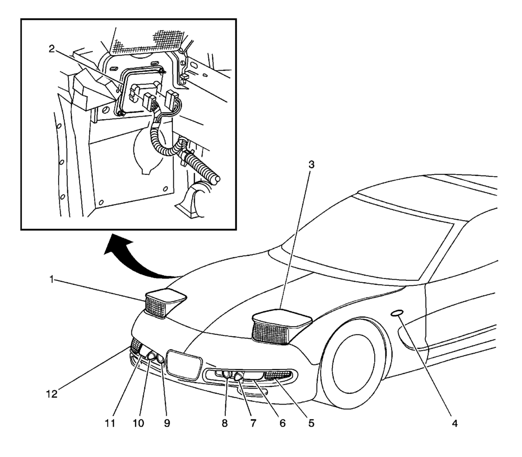

Have a friend who had an accident in his car, and has to replace this box, anyone know what it is ?
according to him, it is a box with two large connectors, sitting on the same bracket that holds passenger head lamp assembly

Headlamp Door Control Module, #2.

Its probably the headlamp controller.

As stated, it's the headlight control module. It sends the open/close voltage to the headlight motors and senses when the headlight has reached it's movement limit.
