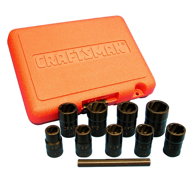

Already have it soaking in PB Blaster...
those sockets are for ones that the nuts are hosed... mine's not rounded or anything.

It'll grab it and not let go until it turns. Trust me, if your bolt is as stubborn as mine was it's going to get stripped and you'll need that socket.

I did the same exact thing, except I rounded the bolt and the Craftsman bolt extracter kit shown above was no help at all. I cut the bottom of the bolt out with a sawzall and had a really low ride. I got sick of being bounced around, so I ended up grabbing the Z06 springs, sways, metal end links, a Zip lowering kit and some Biltstein shocks for the lower stance and I am currently in the process of installing it all.
