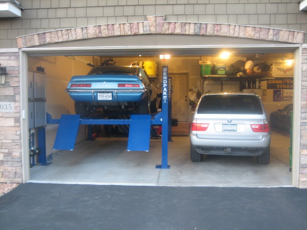

For primarily storage, a four-poster is best.
I really like the Bend Pak HD-9 I bought a few years ago. It is definitely the defining accessory of the garage and has allowed me to not only do things I would have not otherwise tried without a lift, but has made living in a cold climate with three cars easier (warmer winter morning starts!). The HD-9 is available in both 110V and 220V but I opted for the 220V version for faster upward travel, although, I doubt it makes a lot of difference to the residential owner.
I looked at American-made (if that was discernable) lifts. My list was All-American Lifts, Bend Pak, Revolution (Rotary) and Backyard Buddy. Bend Pak seemed the logical choice although, you need to have a small compressed air supply to run the lock release system which I already had so it was not an issue.
My ceiling is 10 feet high and I park one C5 under and one C5 on the lift.

I also have a BEND PAK HD9 series. This is my third home shop lift in twelve years.
Whatever you decide to buy, make sure you've done your homework and research. Every manufacturer should provide you with information in the mail or via a website. Compare structural/standard features, warranty, service parts availability, options, etc.
Also, look for ALI and ETL certifications on the lift. Those are independent testing certifications on automotive lifts. By the way, a commercial grade lift doesn't cost much more than a hobby grade and will be engineered for better load capacities.
Your pride and joy will be on top and you'll be beneath the lift, so don't go cheapest on this purchase.

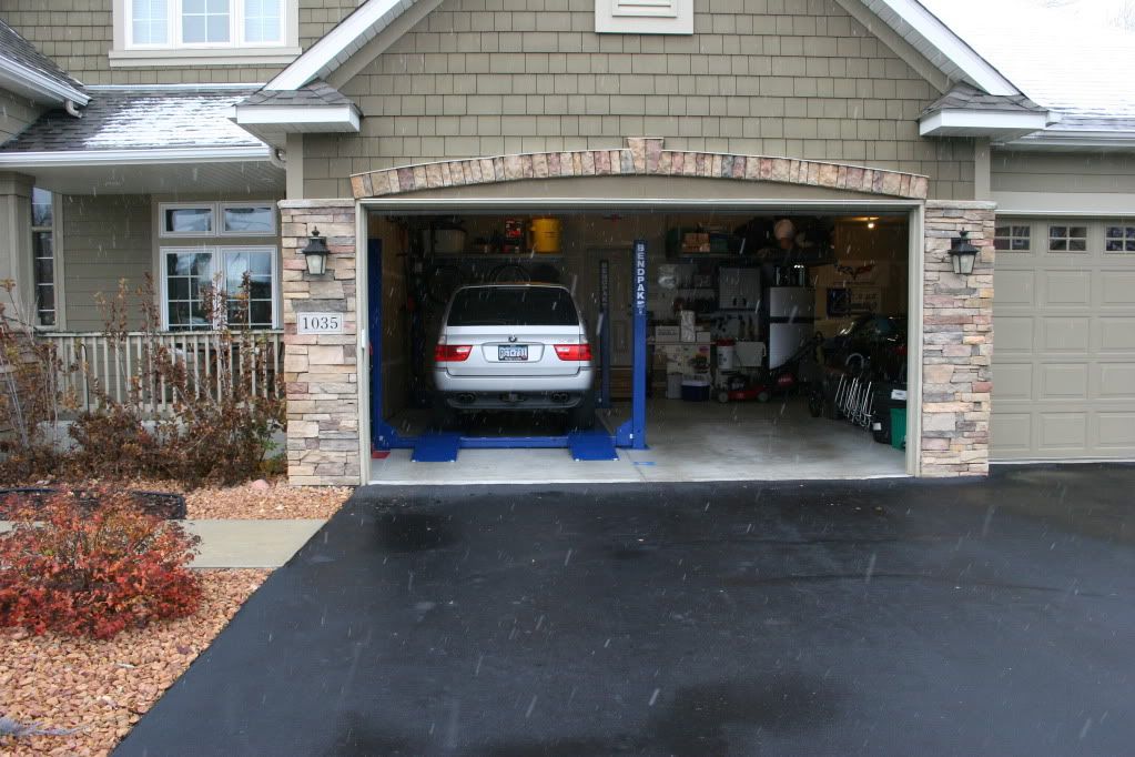

Patches and Captej were influential in my decision to buy the BendPak HD-9.. You really do need the extra width of the HD-9 for a Z (don't know what you drive).
My garage height is 10' 6" and unlike Patches, I didn't think to build this side of the garage with an 18' or 20' wide 'main' door. Mine is 16' and as you can see, the HD-9 takes more than 1/2 the width. No trouble, my mid-size SUV or my wife's sedan easily fit in that spot.
I park my SUV on the lift ramps every day.
4 posts aren't exactly optimal for wheel removal, but do remarkably well for other maintenance. See Captej's threads showing his HD-9 with a rolling/sliding bridge jack.
Really couldn't be happier - it's an invaluable tool and IMO, the best lift on the market.
