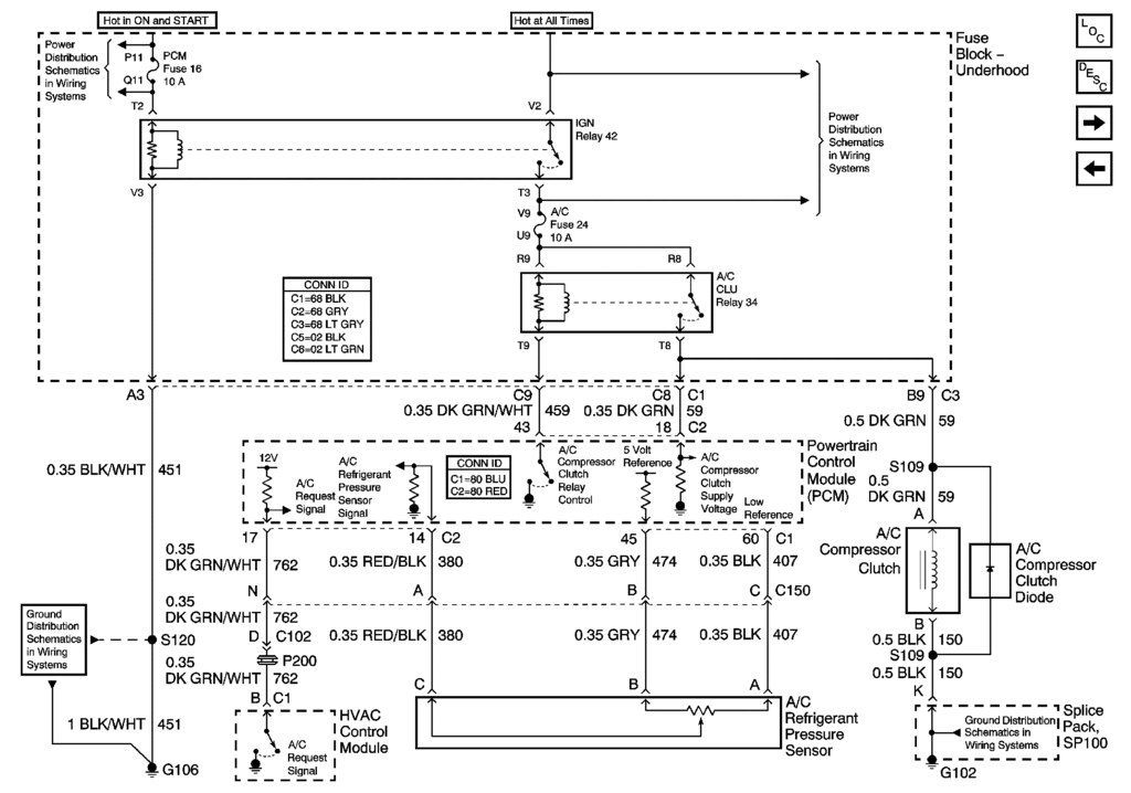

Ok, my a/c blows hot, so I tried to add 134a -- initially my static pressure was 0 on both ports, but it holds 134a. I brought it up to 100psi on both side (76* ambient) but couldn't get the clutch to engage.
I disconnected the battery for 15 minutes, but no dice. I verified with EFI that the pressure sensor is sending a voltage of 1.2 (have no idea what that actually means, however).
Is the compressor toast?
Sensor bad?
Any ideas of where to look next will be appreciated.

Are you getting power to the compressor with the AC turned on?

you know what Lucky would say? And he would be right! "CODES"

No codes. It's a manual AC.
I'm not sure how to check if the AC clutch is getting power with the engine running?

OK, this and a Meter ought to get you going.

Yeah, wasn't thinking the other night. I was trying to figure out how to check the clutch internally rather than checking the relays and harness
I did find out that I can't command the A/C clutch on or off with EFI, so it's either at the relay, harness issue or in the compressor.
