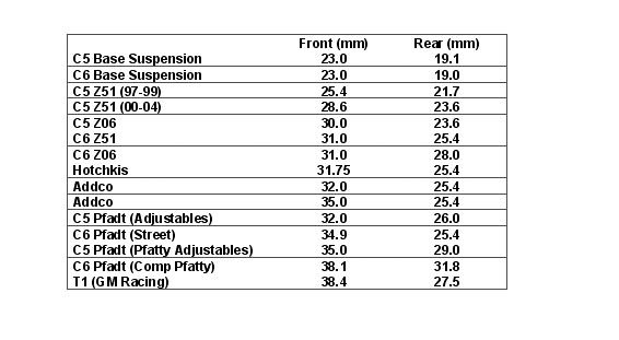

those look like c5 z06 bars, not c6 as what hes installing on his

They are C6 Z06 bars. Gene had a sale on them a few months ago along with C6 Z51 bars for a steal and several dozen of us got in on the deal. If you don't believe that, PM Gene yourself.
Better yet, re-read my post and you'll see the rear bar measured ~1.19" (~28 mm) while the front measured ~1-1/4" (~31 mm). Check the chart below and you'll see the C5 Z06 bars are 23.6 mm and 30 mm, rear and front resp. while the C6 Z06 bars are what mine measured.
Also, the part numbers are for the C6 Z06 bars.
