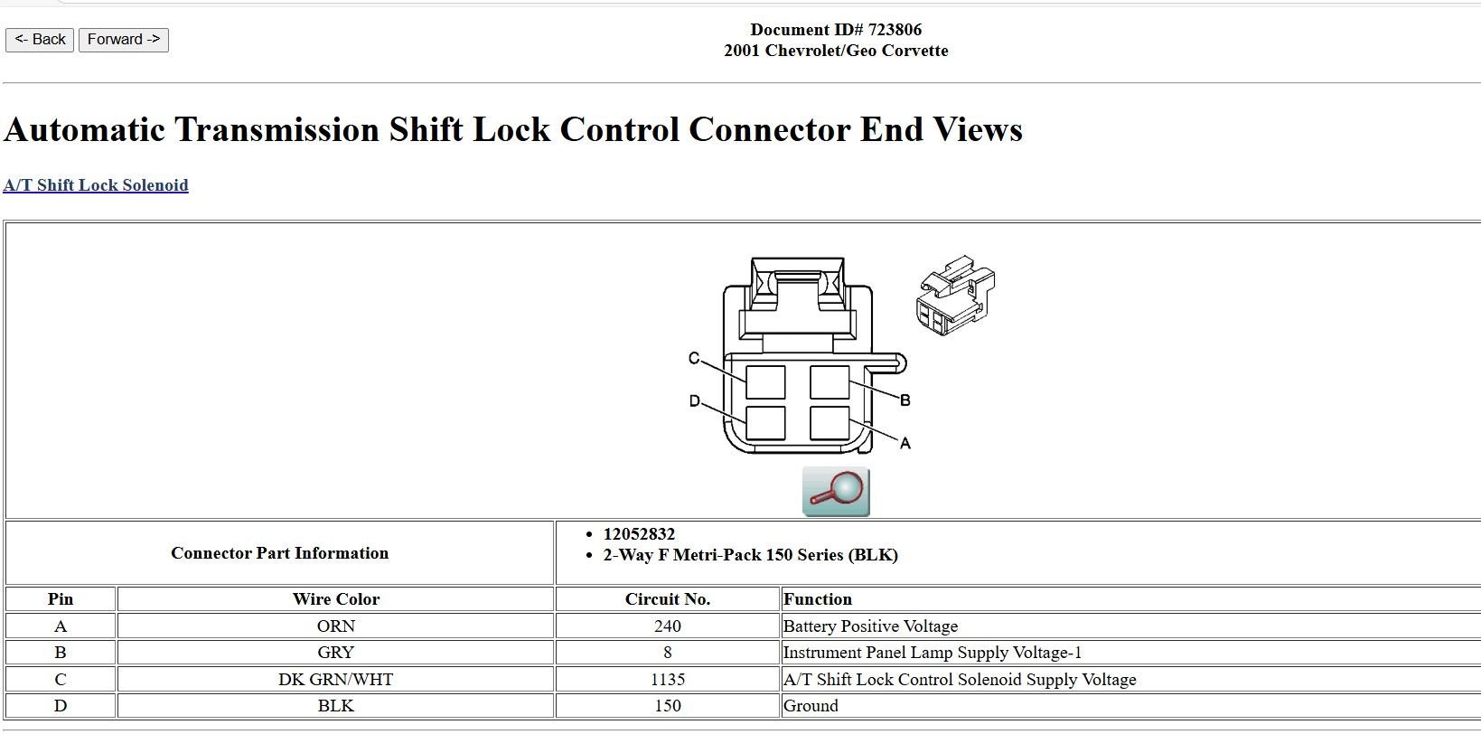

Two wires for that shift lock solenoid should be:
Dark Green with a white stripe
Black

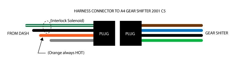

Originally Posted by lucky131969
This diagram corresponds to what I see (Thanks!)
I am attaching a diagram I made of that same connector based on what I see - the incoming harness wiring matches your diagram.
The question is which wires would I need to reconnect to get my PRDN123 lettering to light up again (when I open the door, night driving, etc.)? Maybe the Grey wire and perhaps the black wire? (I am no electrician). If I could figure this out, I thought maybe I could just remove the pins from the connector I no longer use for the solenoid and just plug the connector back in? Not sure if that is a good plan?
Any reason why you do not disconnect the connector from the solenoid and be done with it? I assume you do not want to dig into the shifter more, else this would solve the issue. Another path is to just remove the brown wire contact from the shifter receptacle and plug it back up.
You are correct, I have had the entire connector unplugged for several days now and that appears to have bypassed the sticking solenoid issue.
The reason I resurrected this thread from 2010 (rather than start a new topic) is because vett79 in his post #7 above asked the same question back then (with no answer). He had simply unplugged his connector but then discovered that his gear selector indicator letters (PRND123) no longer lit up at night on the shifter (unintended consequence of unplugging entire connector). We both wanted to just deactivate the defective solenoid, not all the other functionality the connector provided.
