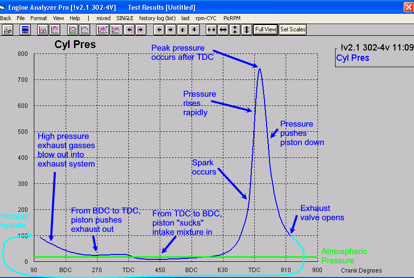

Cranking Discussion
First, remember the compression pressure peak is not instantaneous nor is it regulated strictly by cranking RPM or VE. During cranking a spark creates higher than cranking compression, so really we could be looking at a difference of (100)'s of PSI not just 10 or 20 during a sparkless cranking compression cycle. The pressure peak of a cylinder is what may wear rod bearings and bend rods, it is the most abusive type of stress to place on an engine in my opinion.
Next we should understand the difference between instantaneous and integral stress. If we pick a specific point on the graph above for example 750psi peak pressure, we can determine the stress placed on the piston/rod/bearing/oil film etc... However this is only 1 specific point of stress and does not include any of the other points leading up to that peak. The other points when taken together are called an integral of pressure, or the area under the curve of cylinder pressure or if we want to call it the area under the curve of pressure over some area of a piston surface which relates directly to the stress applied to the rod and rod bearing and so forth (down the drivetrain). So lets say we increase the cylinder pressure 1 psi at every point- 1psi by itself instantaneously is insignificant of course. But when taken together we have an extra 1psi across the board for the entire duration of a revolution through the compression cycle, this extra shear stress applied constantly to the oil film is acting as an integral function, or a 'accumulative' or 'summation' style function which is going to have a much greater overall impact at the end of the rotation than if we just increased the pressure at a single point in the curve for a split .0001 second.
Next, oil flow must be compared to these stress forces,
The affect is cumulative as oil flow is not immediate. The engine will take something like 800rpm for lets say 5 to 10 seconds for oil to make its way from the back of the engine to the front. Your oil pressure sensor pegs out at say 40psi in the first second or two but the oil does not reach the cylinder #1 rod bearing for another 5 to 10 seconds or whatever. The lifters take another 5 to 10 seconds over that as well, they are even slower to receive the oil.
Summary
-The pressure rise in the cylinder due to small changes of compression may be 'small' while it is enhanced via combustion
-Pressure and stress are taken as an accumulative integral function applied to the fluid film protecting rod bearings over many revolutions
-The engine may experience (800rpm for 10 seconds) around 130 revolutions without oil pressure while an additional 100~psi (for a slight compression increase) is applied to the rod bearing of cylinder #1
And there is also the rate of fluid flow into the bearing compared to the rate of it leaving over time. Some oil is pumped in while some leaves based on applied shear stress the oil is squeezed out of the bearing. As RPM increases generally more is leaving and less is entering due to losses from various sources mostly friction I guess. At some point there is enough oil leaving the film is weak enough to encourage bearing wear. This point will be sooner the more pressure is applied to the bearing due to cylinder pressure. Higher RPM engines will survive more easily with reduced compression.
