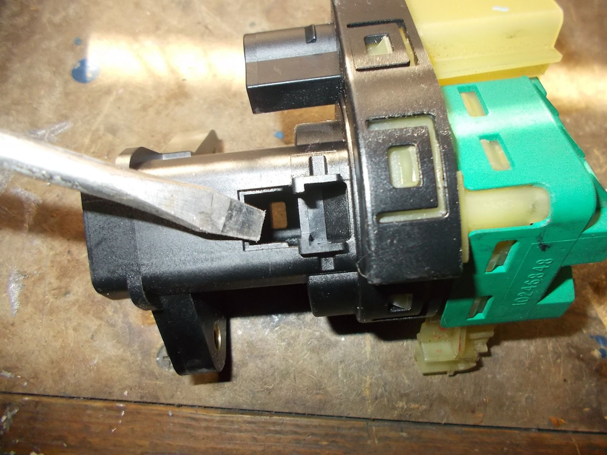

Hey guys, first time on the forum, I have a 99 auto coupe and am experiencing the same issue. Went into a store, got back and the key would not turn. Tried all the usual stuff, tapping the key lightly, a little WD-40 and turning the wheel back and forth with no luck. Called AAA, they sent a locksmith and he tried but was unsuccessful as well. Got the Car towed home and am reviewing posts on the forum on switch and cylinder replacement. I have replaced a worn cylinder before on other cars and know you have to get the key to turn to at least accessory to so you can push in the pin and remove the lock cylinder. There a few U-tube videos on removal and replacement of a C5 ignition switch and cylinder assembly, but some seem to contradict each other. Can someone point me to the correct procedure? Also, don't know if this makes a difference, but the steering wheel does move freely in both directions..

Heres a DIY from the stickies at the top of the C5 tech forum. Scroll down to the part that's copied from a factory service manual.
https://www.corvetteforum.com/forums...ch-repair.html

I just replace my ignition switch. On mine all I had to do was insert the key and push down on the retaining pin and it pulled right out.

Well, unfortunately, with my 99 auto, cannot remove the center console because I still can't turn the key and shift gears and therefore cannot remove the cable from the switch. So how do I remove the steering cable from the shifter with the console still in place? I can lift up the console a little and see the cable from the side but am worried damaging something. Also, does the VATS sensor just pull out of the key cylinder? I am an old school monkey wrenchin' guy, but all this new stuff kinda makes me hesitant...
