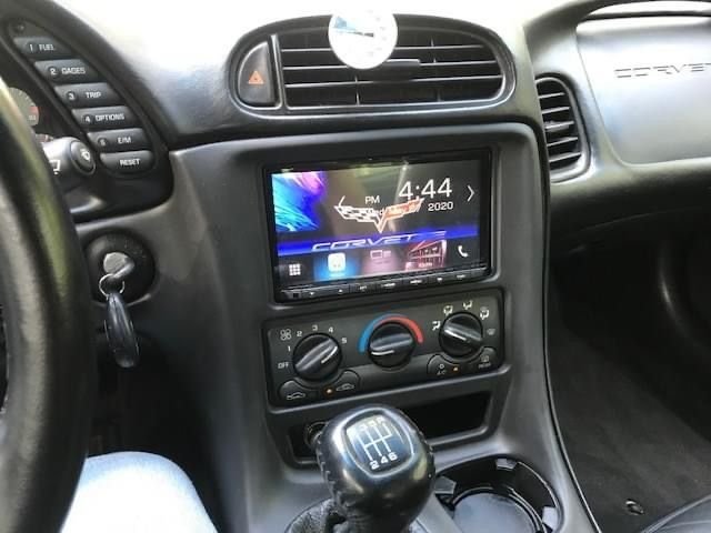

Old Aug 11, 2021 | 10:18 AM
  #38
ffas23's Avatar
ffas23
Joined: Jan 2003
Posts: 2,817
Likes: 21
From: Somerset, NJ
Originally Posted by johndill54
I’ve had a 2000 C5 since new, it only has 21K miles, been garaged since new. My CD changer just died. Would love to hear about this bypass option if it’s still a viable fix
This is a 11 year old thread. Do what I finally ended up doing and others did and buy a new head unit for your car and don’t look back. You will have a Library of Music at your Fingertips plus hands free calling the most important feature of all to update you C5. Yep hands free calling and Apple CarPlay updates mine through today and also updated the looks inside my C5.
