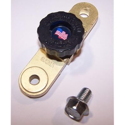

I use a manual disconnect switch that makes the connection instantly, and avoids this entirely. It's pretty handy. Search for "side post disconnect switch", it looks like this.

I've previously used one of those **** type "disconnects" in the top post version. I found the **** didn't always provide enough tension to maintain a tight connection.
After a couple of years in the hot engine bay, the green plastic **** broke off.
These type of solenoid battery disconnect switches offer positive on/off without tools, are easily hidden from prying eyes/hands, allow for power to the memory controls and offer theft prevention...
http://www.watsons-streetworks.com/battery.html
