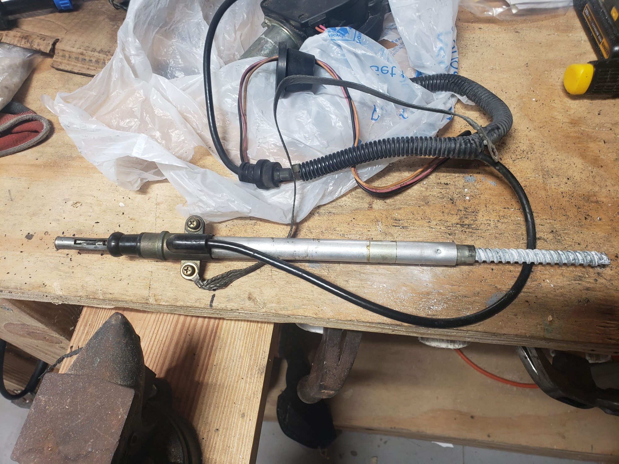

Default Stuck mast
Hey all
I am not able to get the mast to come out of the motor housing up tube.
I’ve replaced this type of mast on other vehicles and after removing the nut they all just came rout out just like I see videos this one should. Nope not this one. I tried in the car and finally decided to remove it and out in vise to pull harder so as to not damage car and still nope.
im guessing the small connection tube is corroded inside the housing and frozen in place.
now soaking with penetrant but thought perhaps somebody on here has dealt with this and knows a trick or advice that it’s a lost cause and get an entirely new assembly?

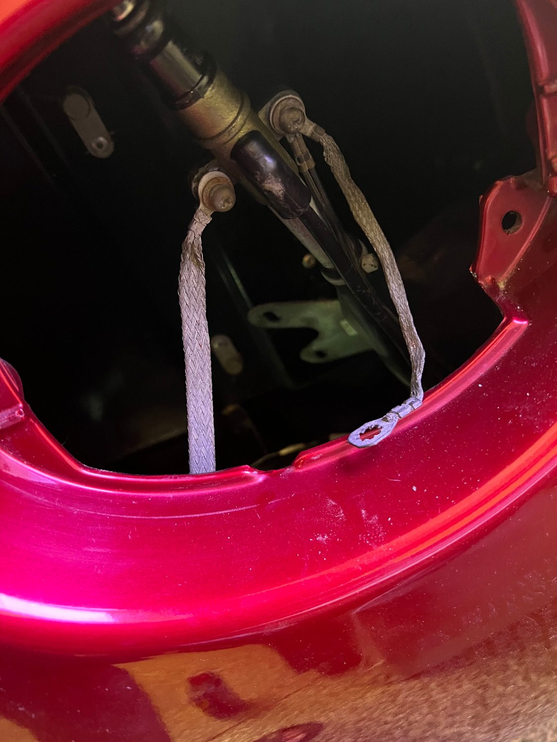

oh and while I got you- on the mast casting there are two Phillips screws connecting grounds. One goes to frame one has double on it with one to wire harnesss and another short 3”
braided one just loose on the other end. WTAF? Where’s that supposed to go
thanks

Old Jun 8, 2022 | 09:28 AM
Chucklehead2's Avatar
Chucklehead2
Joined: May 2022
Posts: 18
Likes: 5
From: Fort Wayne, IN
Thanks - I've contemplated that and still am - my hesitation is that there ALWAYS seems to be some punk *** little ******** who wants to reef on things like this when they walk by.
Add to it being a vette and the fact there's plenty of haters as well and the likelihood of it happening goes up.
Lost all confidence in being able to 'trust' that the majority of humans will do the right thing/exhibit respect - those are minorities now.
Oh and for the mystery strap that was just hanging in there i've found that apparently it's supposed to go onto some stud in the bent U channel under the rear facia.
I did see also that there is a way to disassemble the casting from the motor and be able to pull the antenna out the bottom vs the top - opening this up will then enable me to pound it through to get it out....
When i get back to it i'll fix the strap connection and see about the mast removal

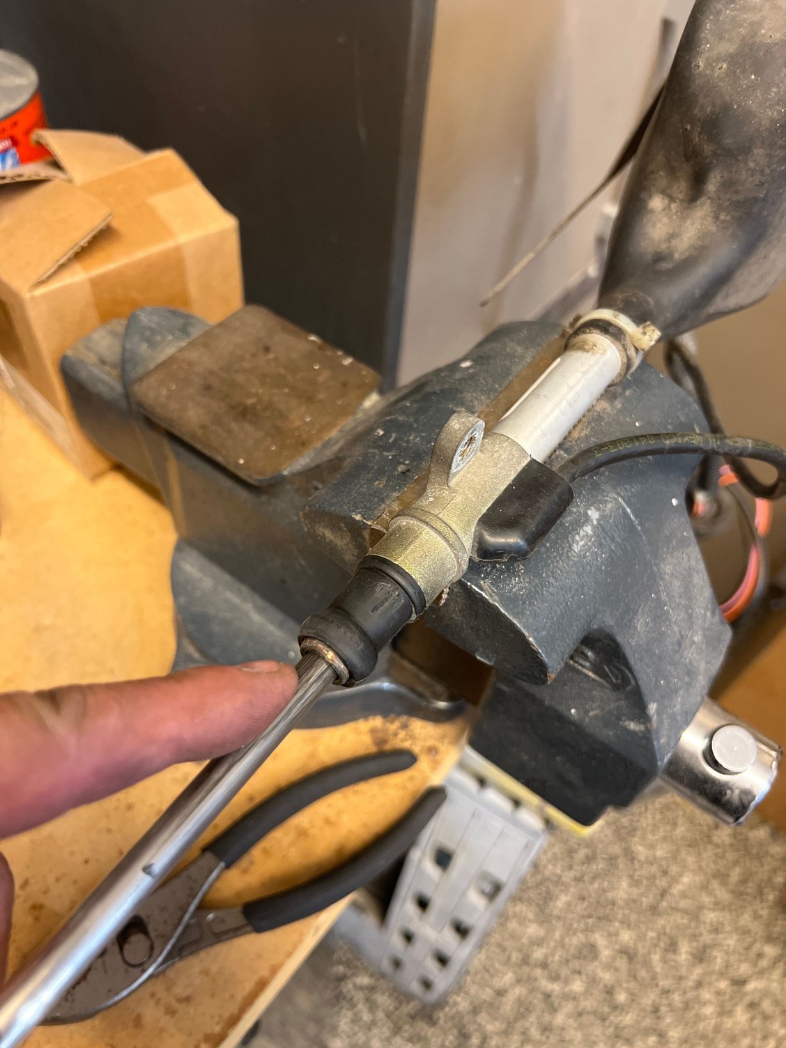

I am having the same issue with broken parts inside the motor. The motor appears to be put together with plastic rivets. How did you remove them and then how did you et them back together?
Old Jun 22, 2024 | 03:30 PM
tawc5's Avatar
tawc5
Joined: Aug 2002
Posts: 23
From: Palm Beach Gardens FL
I had the same issue in getting the collar out of the unit. I found that a concrete drill bit was the perfect size to force the collar out. Now...can anyone help me figure out how to get the plastic rivets out of the motor so I can remove the broken strap parts?
