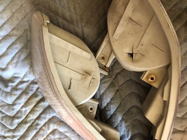

Check the turn signal housings. After years of driving the bulbs melt the top of the housing and cause cracks. This will allow water in and pop the bulbs.
I just changed my over the weekend and both were melted open and both sockets were burnt. I also changed out the sockets with new ones.
