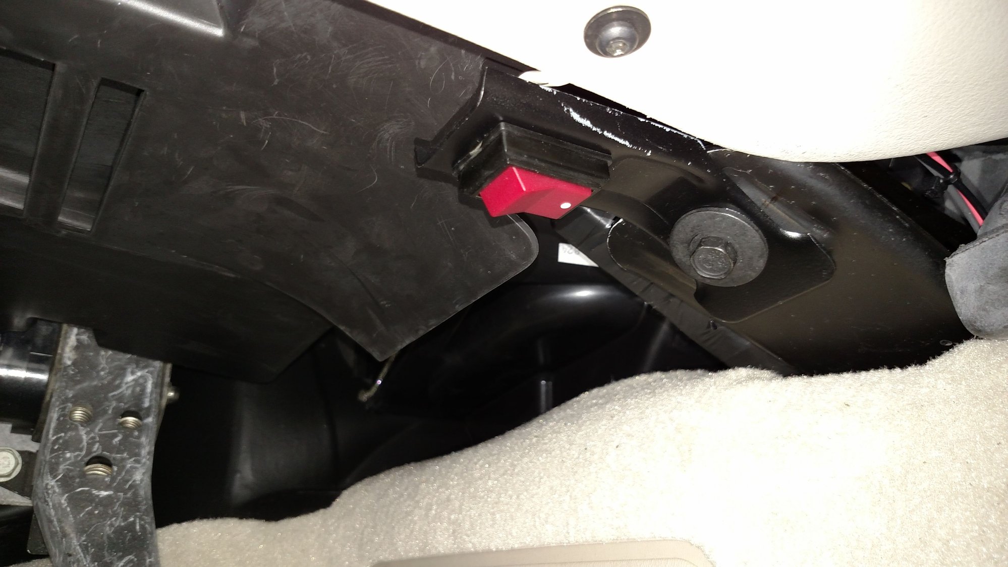

Fuse 25 in the fuse/relay panel under the passenger's feet powers those lights among other things. I installed a remote switch connected in series with that fuse, and hid it under the knee bolster. That way I was able to interrupt power to the DIC's backlights after turning off the car, and re-establish it before turning the car on.
Everything was very clean and completely reversible. I used this adapter to put a switch in series with fuse 25:
And one of these:
This is how they looked in the fuse box:
And this how the switch looked installed:
