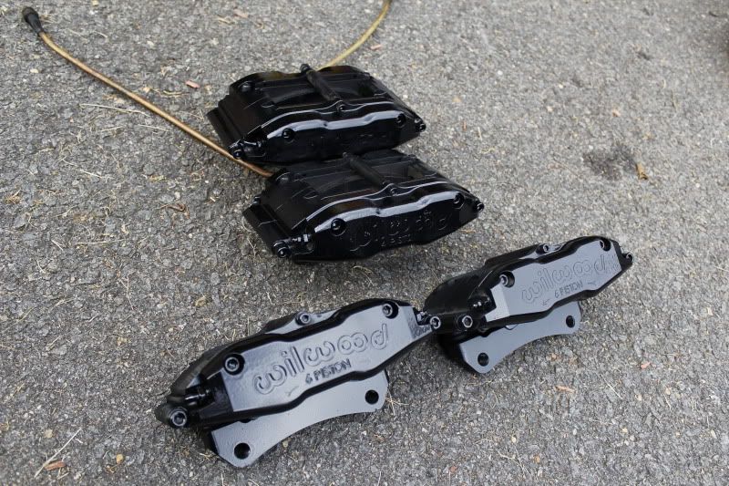

Just picked up a set of 6 Piston fronts 4 piston rears Wilwood calipers for 13" discs with C5 specific mounts.
I Have russel lines on stock calipers will these work?
What rotors should I get that will fit? 99% highway hunter!
What Pads? Again highway hunter.
Shim Kit?
I searched and called wilwood just want real world do's don'ts and best place to purchase parts.
TIA
