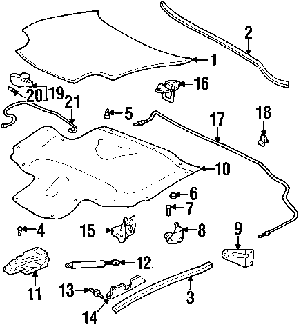

Originally Posted by 8VETTE7
I drilled a small hole to begin with and then took incrementally larger drill bits to open the hole a little at a time untill I could start screwing the bumper into the hole. The center diameter of the bumper is .410. I used a Y drill which is .404 as my last drill. What ever the purpose of the bumper might have been I am using it to push up slightly on the corner of the hood so that the fender, hood and headlight door are all fairly even. Shimming the hinge will not correct the problem of getting 3 items to line up evenly. This did what was needed for me and has been in place for over 3 years. Just be very carefull drilling and make small increases in drill diameter as you enlarge the hole.
Here ia a pic or the bumper out of the hood:
I'm thinking the part I need is #5 in the diagram below. It's labeled "Hood bumper hood side" I'm also wondering about part #s 6 and 7 though. Here's the link: http://store.gmpartshouse.com/parts/...iagram=CF97055
