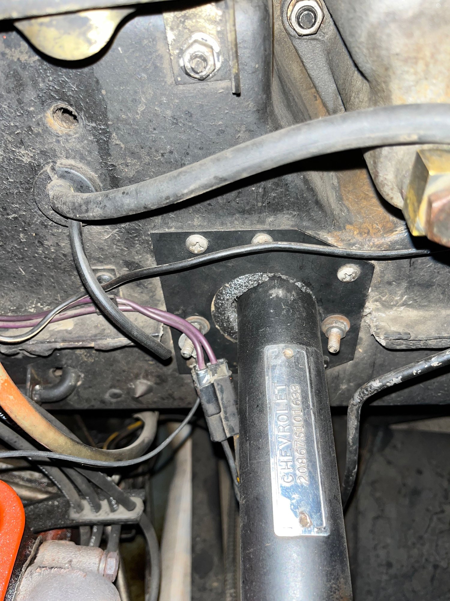

Default photos of EPAS installation
I'm sorry this took so long. I hope the photo of my EPAS installation are helpful. I did it without removing or opening the steering box so I didn't need to re-center the steering wheel. Unfortunately this means I cannot be certain that the box is perfectly adjusted.
For this I'm preparing to bring my C1 to Jeff Reade in L.A. as he's highly regarded by the C1 community. Although he has no experience with EPAS and little interest in them, he's agreed to help me try to get my C1 to track straight, stop wandering, and return to center after turning. He'll be restoring the entire steering system from top to bottom and then we'll send the car to someone who's really good with alignments of C1's.
Hopefully this will eliminate the problems mentioned above and in my previous post above.
