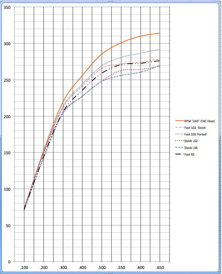

I agree with above - be very careful with PP of the TB -
If can swing a FAST 102 manifold do that over anything else - look over the comparison flow chart below and you'll see why

I understand that the 102mm intake flows better. It is larger, so its a no brainer. But Dynos for our engines specifically show the greatest gain comes from the 90-92mm intakes. It also has a greater potential to keep low end power which I am all about. According to TPiS the 102mm loses slightly on the low end but is the way to go with very high hp applications. That is why I was deciding between the LS6 intake with a 90mm snout, or a FAST 92mm.
