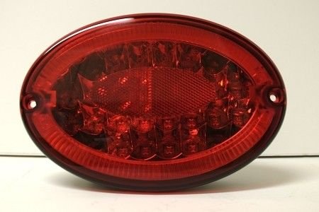

I went to install a set of LED Halo tail lights and when I got the lights the part that plugs in to the stock buld socket had been cut off for some reason. I spliced in a 3157 male adapter and went to install the lights. I think I installed the adapter backwards in the socket intially. Now my tail lights do not work. None of the tail lights or the rear side signal lights work when turning on the parking lights. The brake lights and the turn signals work fine. Also my headlights turn on and off however they will not retract any longer. Everything worked fine a minute or 2 earlier. I assume I shorted something or something like that. Also the headlights work but will not retract anylonger. I only installed one LED light to test. The stock lights are still in the other 3 tail light spots, and they do not work anylonger either.

Just confirming here that 85mm is used for the taillights - right? If so, does anyone have an updated link with ones they purchased that are holding up well?
I found these: https://www.ebay.com/itm/2x-Angel-Ey...8AAOSw71Be3u27

^ Those in the link you show aren't what is referred to as "Halo" tail lights.
These are what you need:
Get them here https://www.corvetteforum.com/forums...ion-times.html
