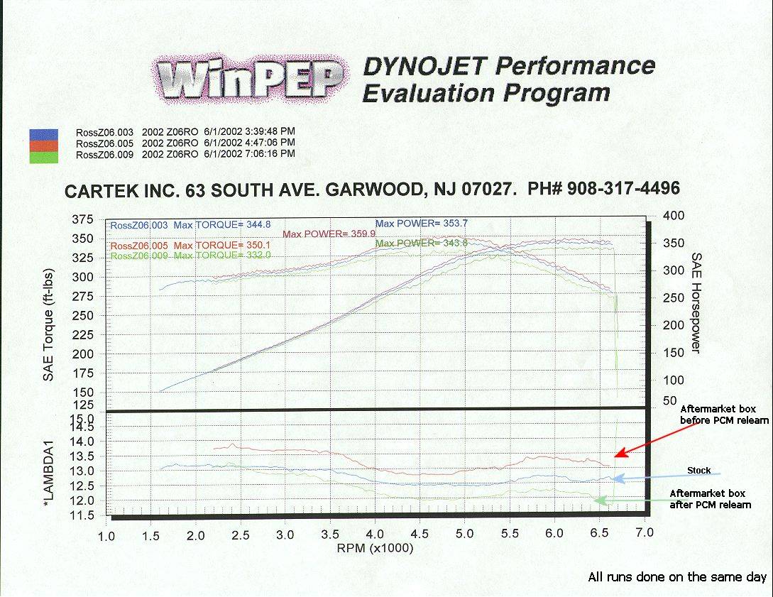

Old Jun 24, 2002 | 06:27 PM
RussBt's Avatar
RussBt
Joined: Jun 2001
Posts: 7,331
Likes: 518
From: Admit Nothing, Deny Everything, Make Counter Accusations.
Default Re: Using Autotap, questions (seanr)
Sean,
I have a T1-C, a MAFT, and a bunch of other bolt-ons going on the car. I wanted to baseline stock just to see where I am at before I start changing things. I did some dyno runs with wideband O2 while stock, and with just a T1-C a few weeks ago and from those results I was able to tell that I needed a MAFT and Autotap. See below. I put the stock airbox back on for now. I am not sure I would trust Autotap O2 B1 & B2 readings at WOT, that is supposed to be out of narrow band range. I am not surprised to see that my WOT autotap A/F ratios are not really close to the wideband reading I got on the dyno. I will see how Autotap reports the rich condition I got when I ran with the T1-C.
BTW - I agree with your 0% LTFT goal.
