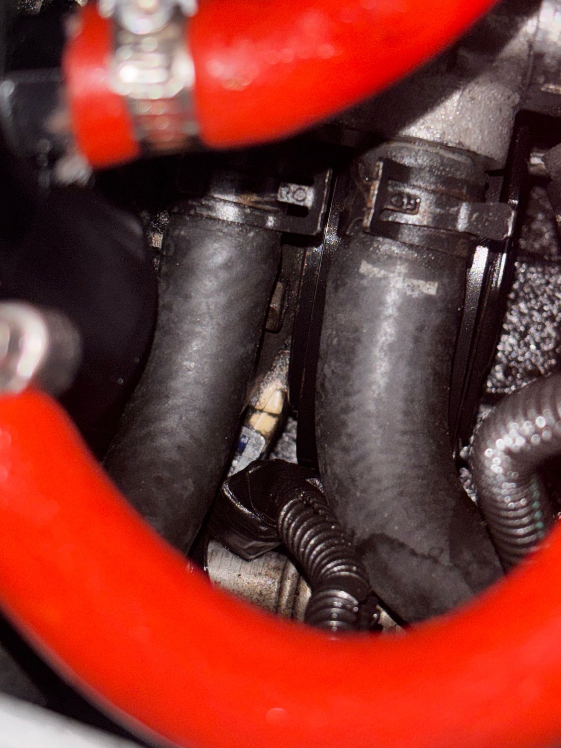

Default I have this problem I do indeed have spillage of oil need help!!
Originally Posted by SaberD
any oil seapage from any of the ac connections? specifically the connections to the compressor. does it still blow cold? it may be some wires contacting your exhaust. I'd get under there and check all around the headers to make sure nothing is contacting them.
so I had a spillage of oil and it seme I have a price of harness stuck on my ac pully would it be possible to just take of the band and run it? Even after spillage I have winter for the next 4 months
