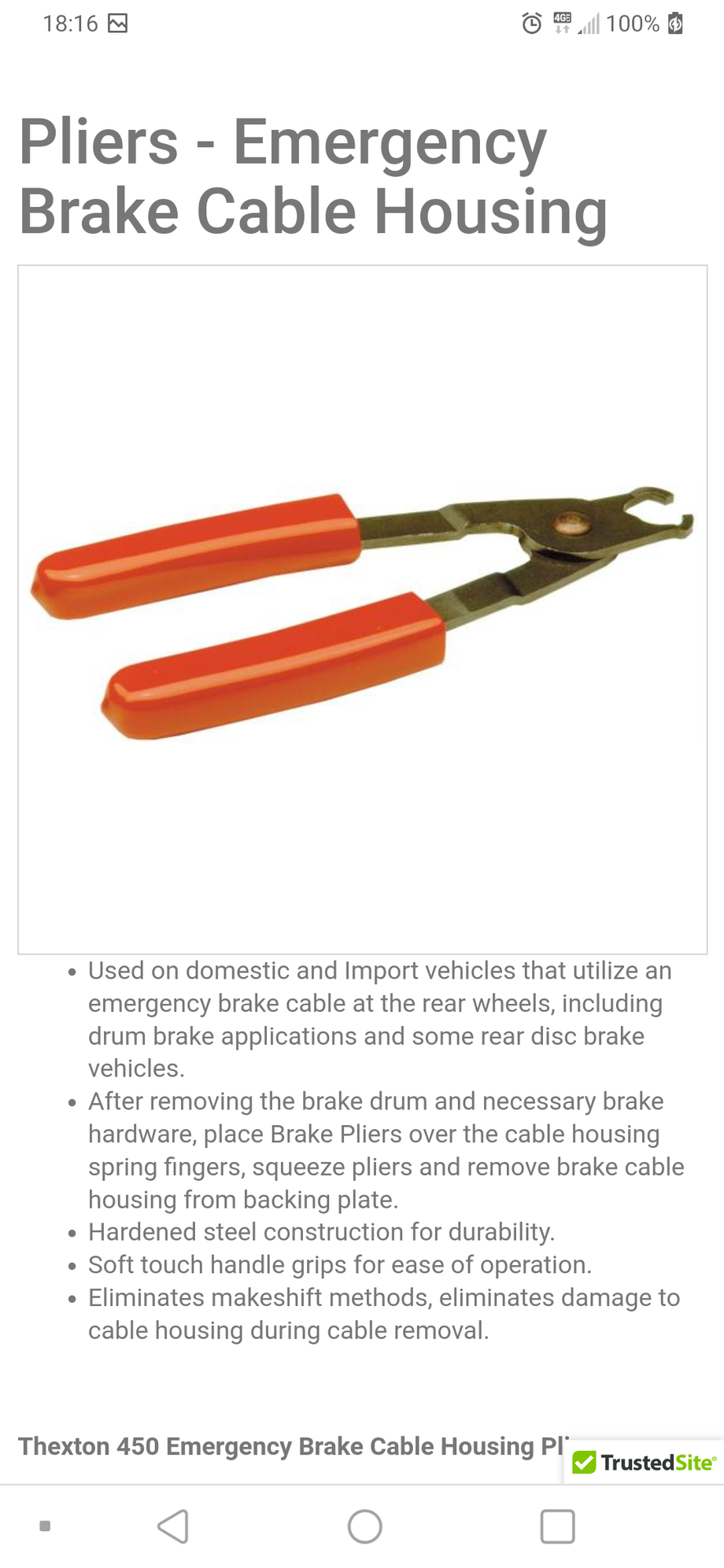

They make a tool for that like pliers. I have them. Worked great every time I needed them.
Have you tried using them on the upper cables on a C5?
Old Jun 8, 2023 | 07:35 PM
ThomasR's Avatar
ThomasR
Joined: Apr 2019
Posts: 2,466
Likes: 699
From: Clark, NJ
Not yet. But one day. They've worked well on every other GM car I've had to work on so far.
