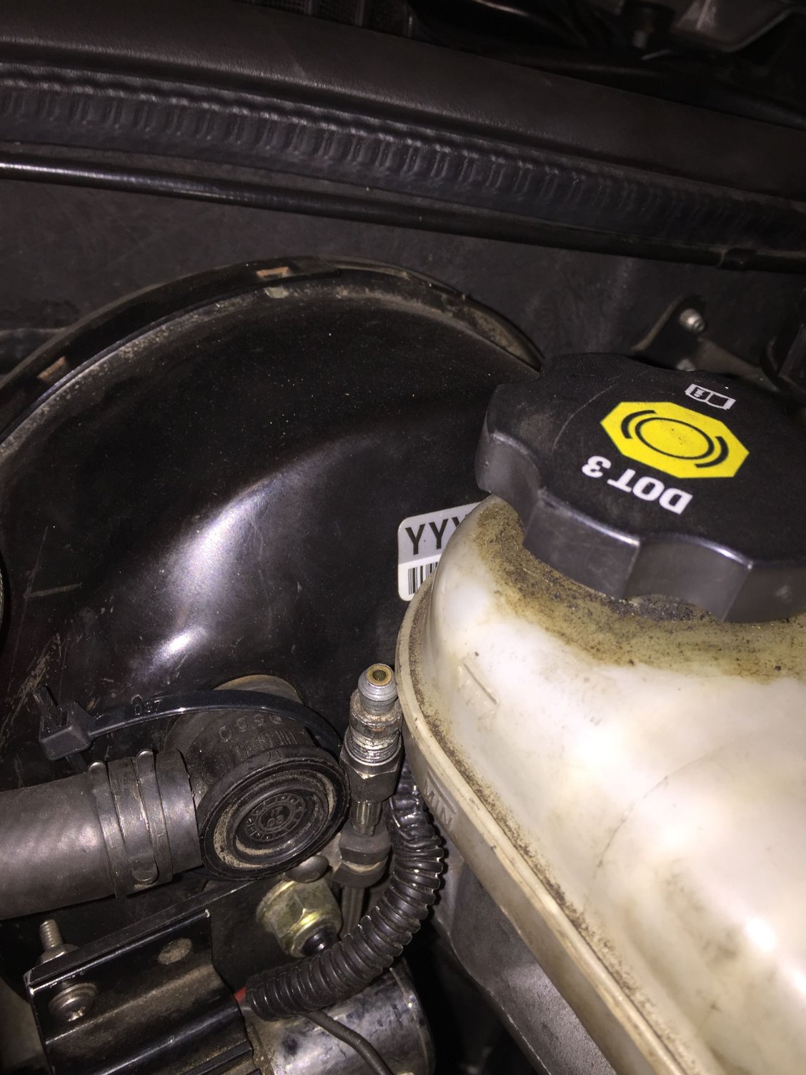

I'm looking to route my remote bleeder, so near the brake booster is good?
Looking for pictures if anyone has any.
Old Jan 16, 2019 | 10:29 PM
493lszosix's Avatar
493lszosix
Joined: Dec 2015
Posts: 662
Likes: 184
From: Knoxville TN
Old Jan 17, 2019 | 08:23 AM
