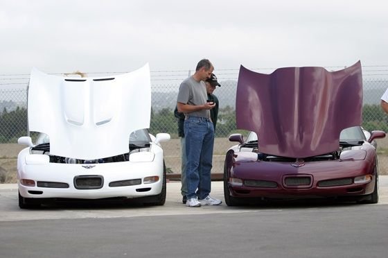

I've had this hood on my car for 12 years without any problems.
