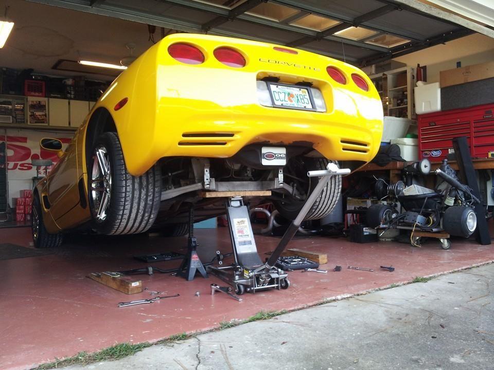

It's not bad to do with the right jack.
When use this method be careful you don't bottom out the nose

Front wheels are chocked. You jack up enough to get under car to unbolt over axle pipes. Then jack the car up fully as you won't be back under it. Slide exhaust out, slide new in lower car to safer level get under and bolt up. The car isn't going anywhere on jackstands.
