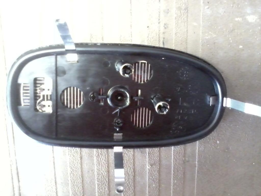

PS: Here is what the back of the mirror looks like.
Mirror Back
Mirror Back
Thanks for posting this. My mirror has been acting up occasionally for the last year. Do you have any recommendation for the silicone lubricant used on the linkage?
