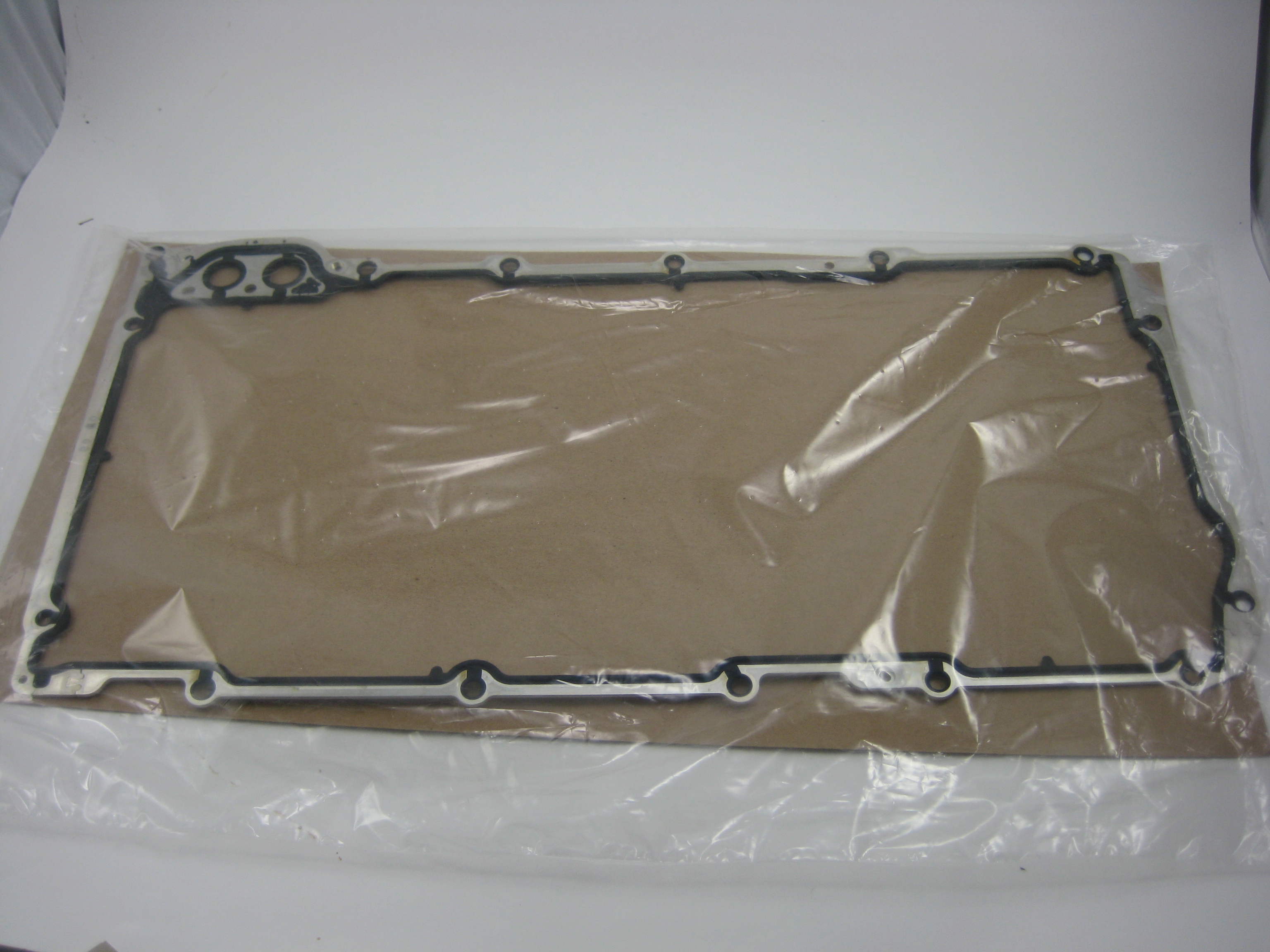

I thought the pan gasket had metal inserts at the holes so you couldn't over compress them.

Originally Posted by baildvetter000
That sounds great but the cover looks tight against the pan now. If I loosen the pan to make clearance and then when tighten it back when I drop the timing cover down wont the pan then leak because I made a new clearance?
when the engine is assembled the covers go on first, then the pan goes on last. the pan gasket is an aluminum frame with a rubber seal molded into it. so what happened is when the cover was removed, the oil pan gasket decompressed and raised up. you are trying to force the gasket down at the same time, thus causing the alignment issue.
