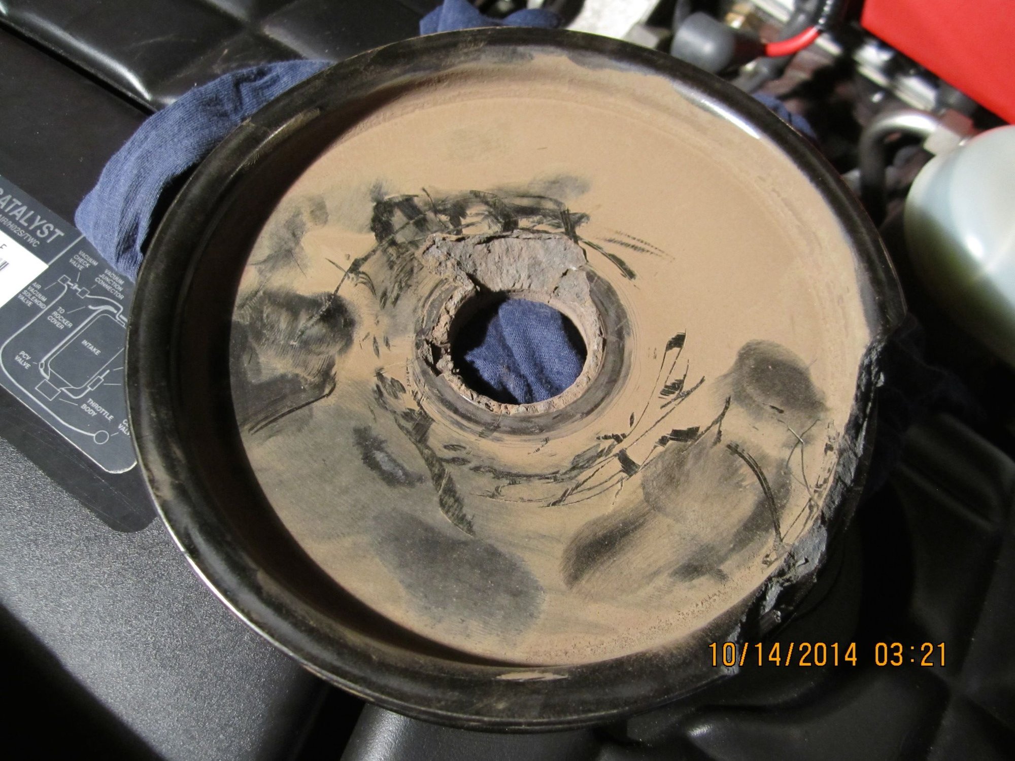

Thanks dadaroo, update, I checked the fluid and it was a brownish color
had never been replaced, so I used a baster to remove what I could an added new fluid stared it up and moved the wheel for a while seem to get better. got in and went for a ride seemed ok. then heard a noise from under the hood temp started rising pulled over to check it out, guess what power steering pulley broken where it bolts on serpentine belt off. just got back
and took it off the flatbed had it towed home, nice start to the day.

well hooks like the pulley was ready to come loose real soon any suggestions should I just change the pulley or pump and pulley is there an ugraded pump and pulley.

What do the experts think pulley just went.

You could try just replacing the pulley and see what happens. If it were me, I would go with a new pump and pulley. Can't help you with anything with regard to non OEM ones. Unless you have some special racing application I would go with stock.

Make sure you get the updated C6 pulley that has cutouts to expose the alternator bracket mounting bolts to make it easier to r&r the bracket and pump if you need to in the future. Actually, the alternator bracket has a rep for failing so GM came out with a new, fortified casting for the later model C5. I have the updated pulley and alt bracket ready to go in during my current project to mitigate this in the future.

thank you all have the C6 pulley ordered and new pump. back together power steering now works great
