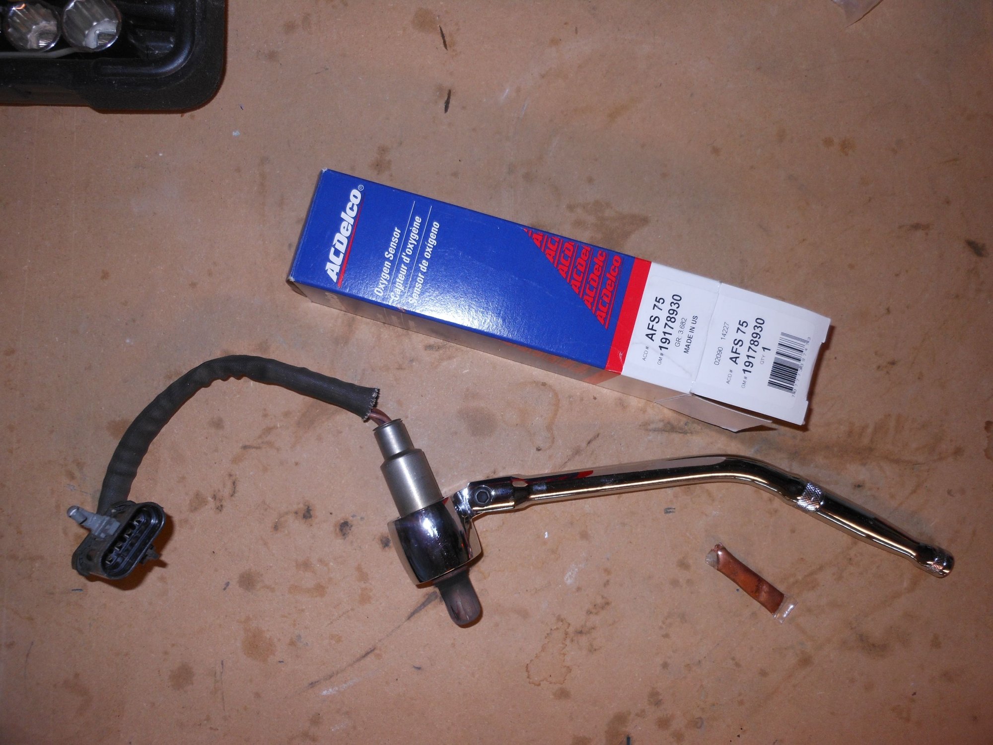

Decided to replace Oxygen sensors on my C5, because it's over 50,000 miles.
As some know, in the garage, with car up on jackstands, makes some jobs awkward. The reach is often difficult while laying on the garage floor as opposed to standing up if you can get the car up on a lift, especially also things are in shadows if you can't get a light in the right spot.

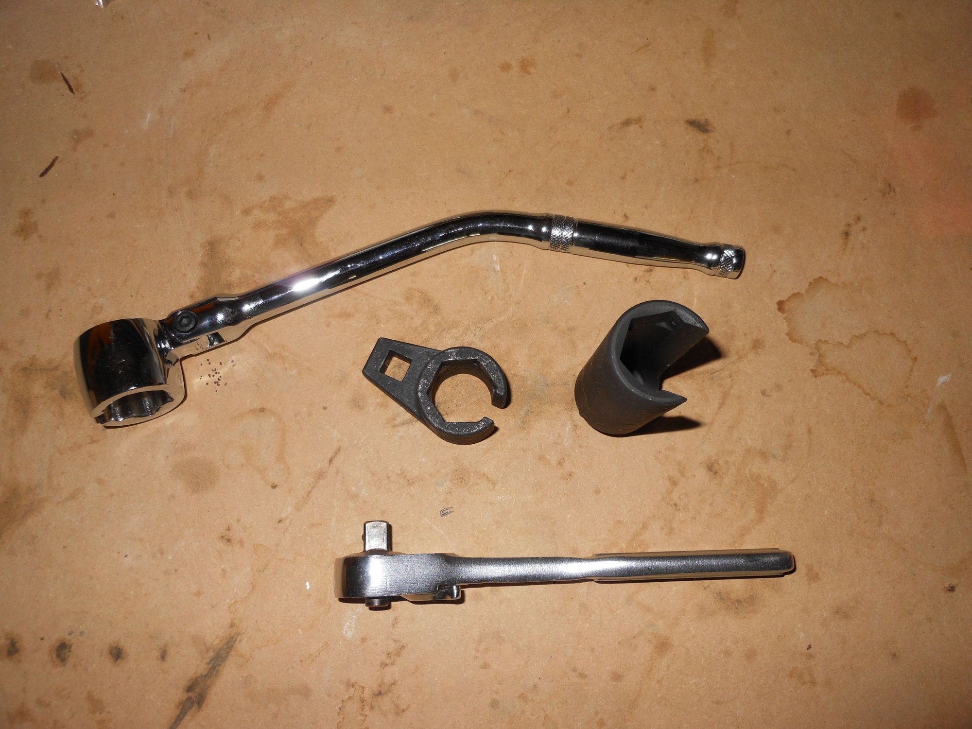

I have to two O2 sensor sockets most have, but couldn't get a ratchet handle on them, very good. Quit for the day, and during the evening, I found this 22mm Oxygen sensor wrench with pivoting head on Amazon, and ordered it.
This thing (wrench) seems 'to have been made' for changing front sensors on C5 Corvette. Slid in easily over the sensor (slot for wires). And pivoting head made it easy to loosen the sensor with no problems, at any angle. Turned this job into a easy two or 3 minutes removal of the sensor on each side (not counting raising the car of course).
Putting in the new ones and snugging them down to about 30 lbs. torque was also easy with this tool. Takes a few minutes more for the wiring harness clip. But not bad at all.
I'm so glad I found this, and wanted to share it with others, who might benefit like me.
If you want to make this job very very easy, this wrench (on sale right now for $16.40 on Amazon) is well worth it.
I'm replacing the rear sensors next, and expect the same ease of removal for them. The pivoting head on this wrench allows an infinity (almost) of angles of approach to the task.
I did spray the sensors with pb blaster the night before, as well. But they did not seem rusted on, at all.
Hope this can help some home diy guys, like me, with this now simple task.
Don
