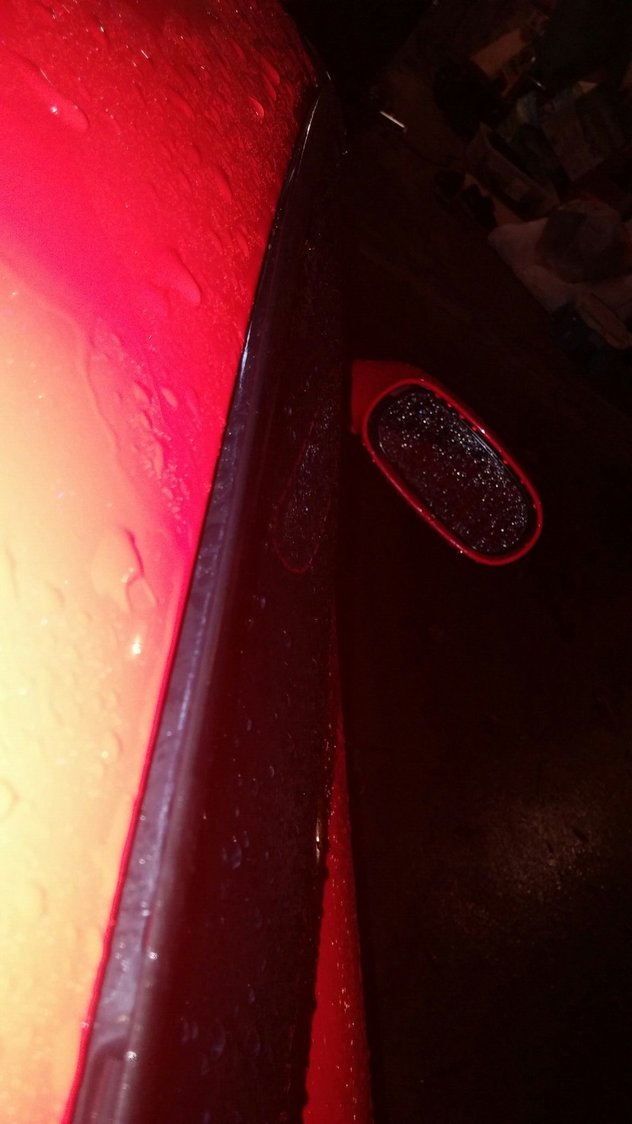

It has been raining hard for the past two weeks, car has been siting outside. I went to grab something from the car and I see that its wet everywhere in the car, floors, roof liner, doors, basically everywhere.
Its a 2003 z06,

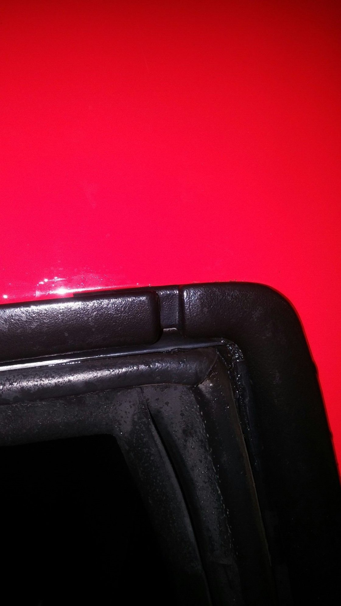

Here are some photos, is it normal to be enough space to fit nickle in the first photo?

Hi
Yeah there is a gap along that piece of trim.
Not to add to the problem but if you can get someone to spray water onto the roof ,one side at a time with you inside the car might narrow down where the water is coming in.
I have had two zo6`s and both had a leak at the top corners ,roof to windshield .
You might be able to remove the rubber weatherstrip without damaging it , see if there are any signs of water between that and the metal rail (retainer).
I replaced the whole lot , metal retainers , roof windshield mouldings and seals .
The small plastic mouldings running down the side of the window b pillar might be ok ,one of those left,right not sure which has been discontinued so if you do remove it try not to damage it they are stuck fast.
Mine were leaking between the roof and the metal retainer so had to remove them to reseal , that's not good because the retainer strips bend real easy (stuck on) when trying to remove .

Will take a look at the bcm area, also is that gap suppose to be there on the door window trim?

Yeah , they all look like that .

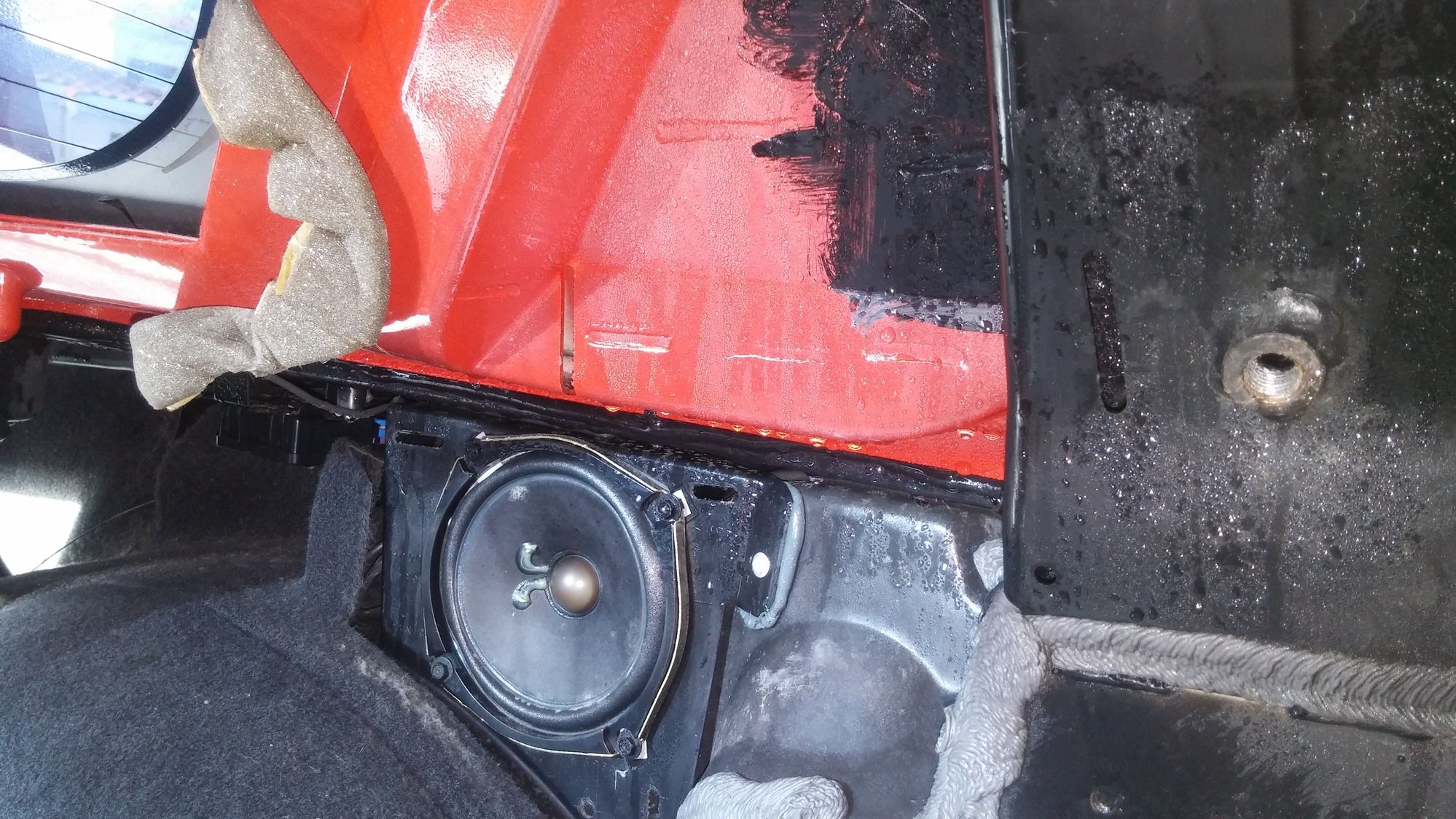

Found more water after taking off the trim.

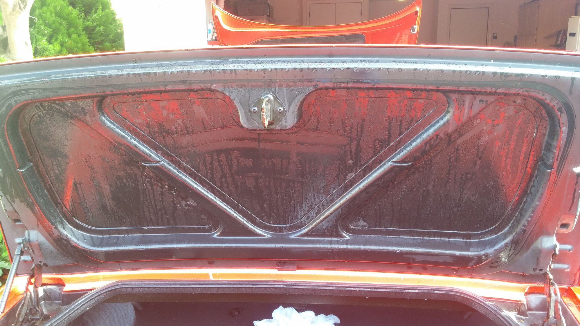

Our hatch looked like yours, covered in moisture, and I found the rear drains were mostly blocked on both sides resulting in water flowing past the hatch seal into the center well... I think I have that leak addressed after cleaning out a ton of leaves and composted material, even had some plants growing from seeds in there!

While checking to be sure the passenger side leak was fixed I found the driver side leaking at the B pillar too. Worse than the passenger side actually. I haven't quite figured out how to remove the upper rear interior trim piece (like you have removed), but I'm hoping I can track down the leak when I get it removed... I think the driver side leak is due to a weather stripping problem, but I can't quite tell. Hoping I can address this leak myself and save a few bucks...
