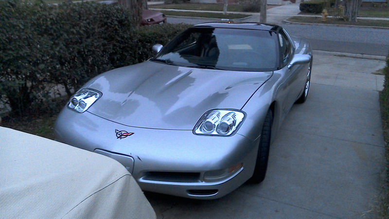

I purchased this '04 C5 yesterday, and this is quite an upgrade from my 75.
but it did come with a few codes that need fixen, here's the list.
