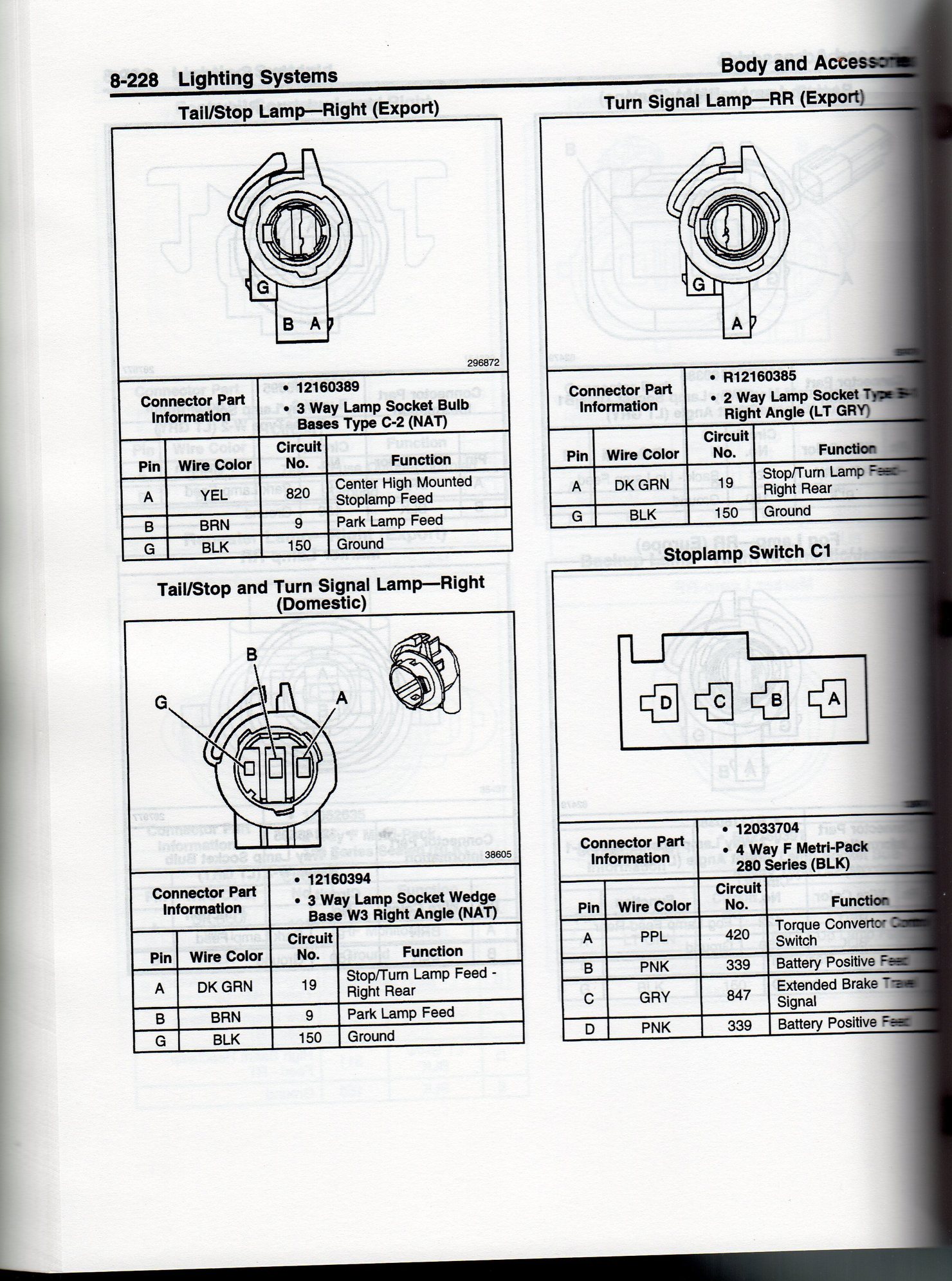

OK, looked in the FSM on P0719. It is not related to TC at all.
I would start by replacing the brake switch. The contacts should be closed until you press the brakes. When they open the PCM loses it's input and deactivates the Torque Converter Clutch solenoid. You could also test the switch to see if it is that or a circuit issue else where. If you need the schematic I can post that too.
I see no danger in driving the car, just don't do it in heavy traffic.
You can see the circuit on this C1 connector view.
Brake Switch C1

Do you think that would cause the reduced power on hard take off?

Yes, re-read what I wrote about the brake switch code.
