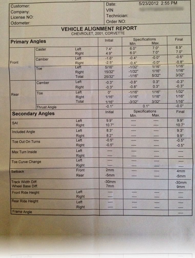

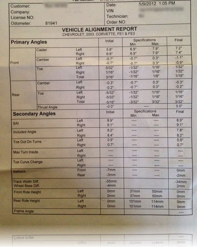

After putting in a set of Pfadt coilovers I had the car aligned. Within two weeks I went back due to very "squirrelly" handling. The second alignment only marginally improved things. My front tires, despite proper pressures, are wearing on the outside. I am perplexed. The final result in first does not match the starting point on second only two weeks later, and the numbers differ tremendously. I am very interested in comments from those of you in the know, as alignment is voodoo to me.

first thought for the major discrepancy is the eccentrics moved out of place on the right side. hopefully they tightened them down really good this time.
