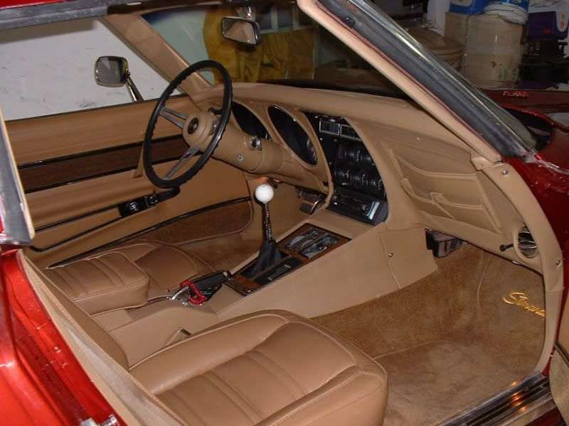

When I had my 75 I just bought new seat foam and new leather covers and they turned out great.

My only problem is I don't have the original seats.
