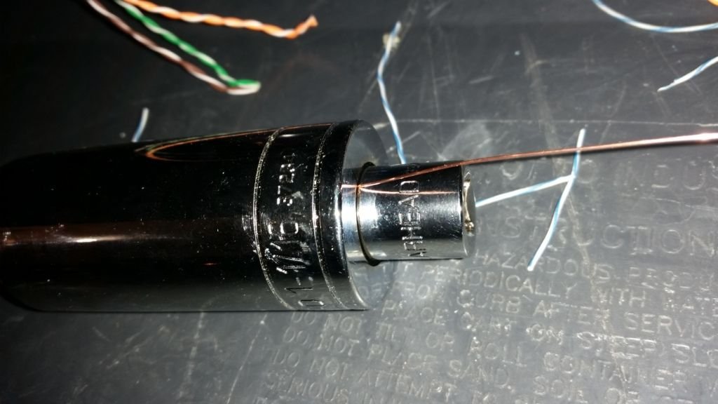

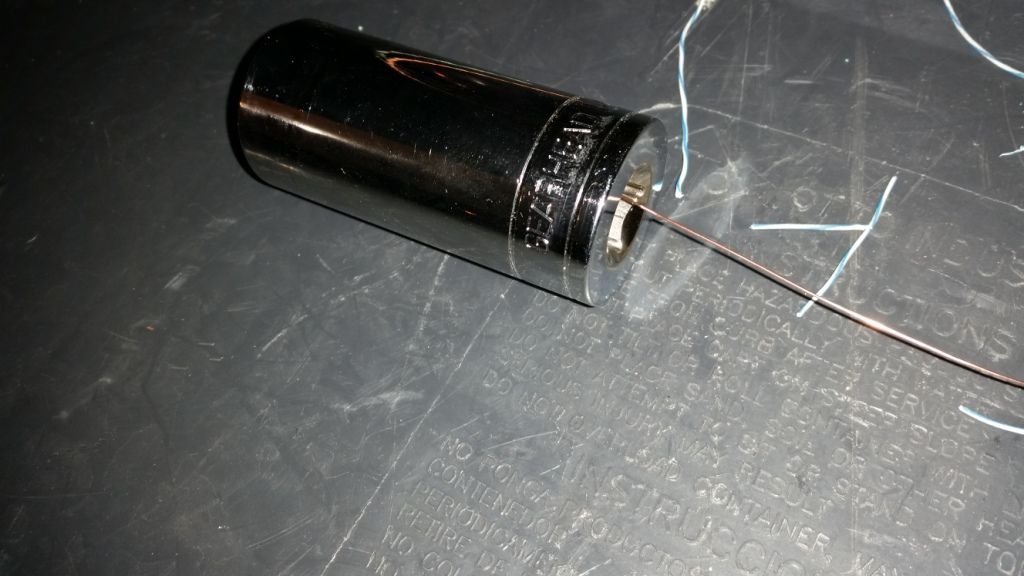

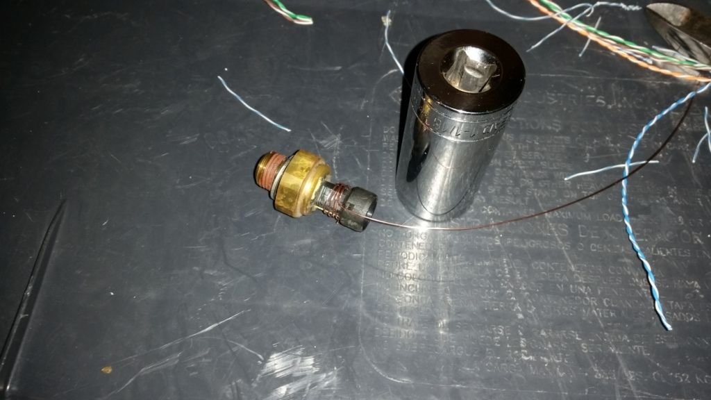

I got this damn thing replaced. I found a couple of little helpful hints along the way.
I used a strand from an ethernet (Internet) cable (CAT5), stripped down to the copper and wrapped it around the plastic portion of the sensor.
Finish the wrap with the copper against the retaining clip.
Slip the wire, still attached to the sensor, through the socket.
Attach your extension, u-joint, or whatever. Once the sensor is tightened down, simply remove the attachments and slide the socket off of the sensor and unwrap the copper from the sensor using a long screw driver as you pull the wire.
Sorry I could get my phone in the area to take photos with my big fingers in the way.
