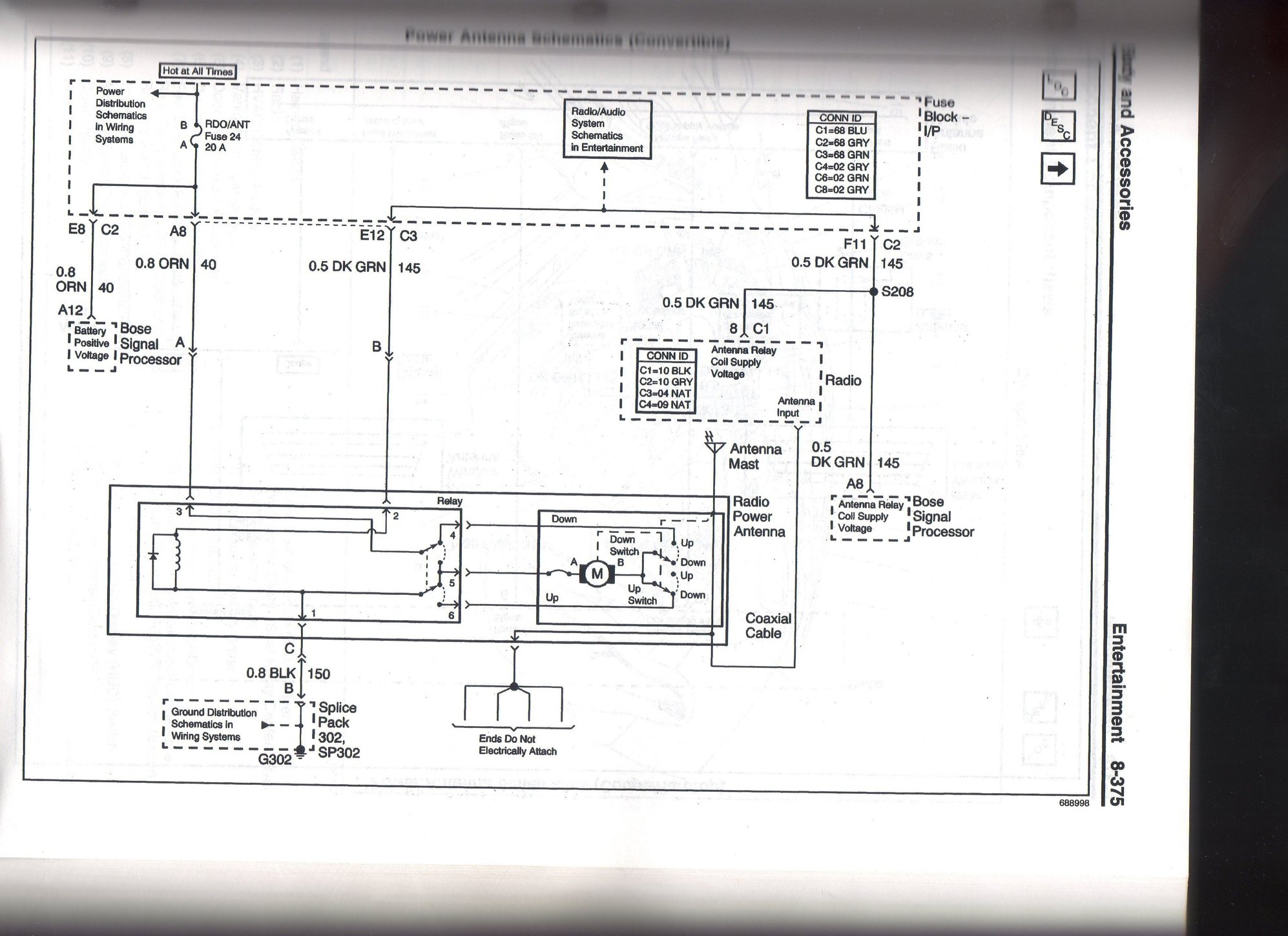

https://www.corvetteforum.com/forums...oes-it-go.html
Old Mar 20, 2015 | 09:12 AM
dadaroo's Avatar
dadaroo
Joined: Mar 2011
Posts: 6,835
Likes: 302
From: Columbia SC
Thanks onspeed. Apparently this is only used on the convertible which uses a power antenna. Here is the schematic and I believe the wire in question to be the one that shows 1 wire becoming 4 wires that are not terminated anywhere. It shows this wire is connected to the coaxial cable, I assume the shielding. I also assume if the lug is used it is connected to the antenna case.
Still can't explain why the schematic shows a split into 4 wires. This schematic is from a 2001. I also verified that this schematic is also applicable to other years like the first convertible in 1998.
Power Antenna
