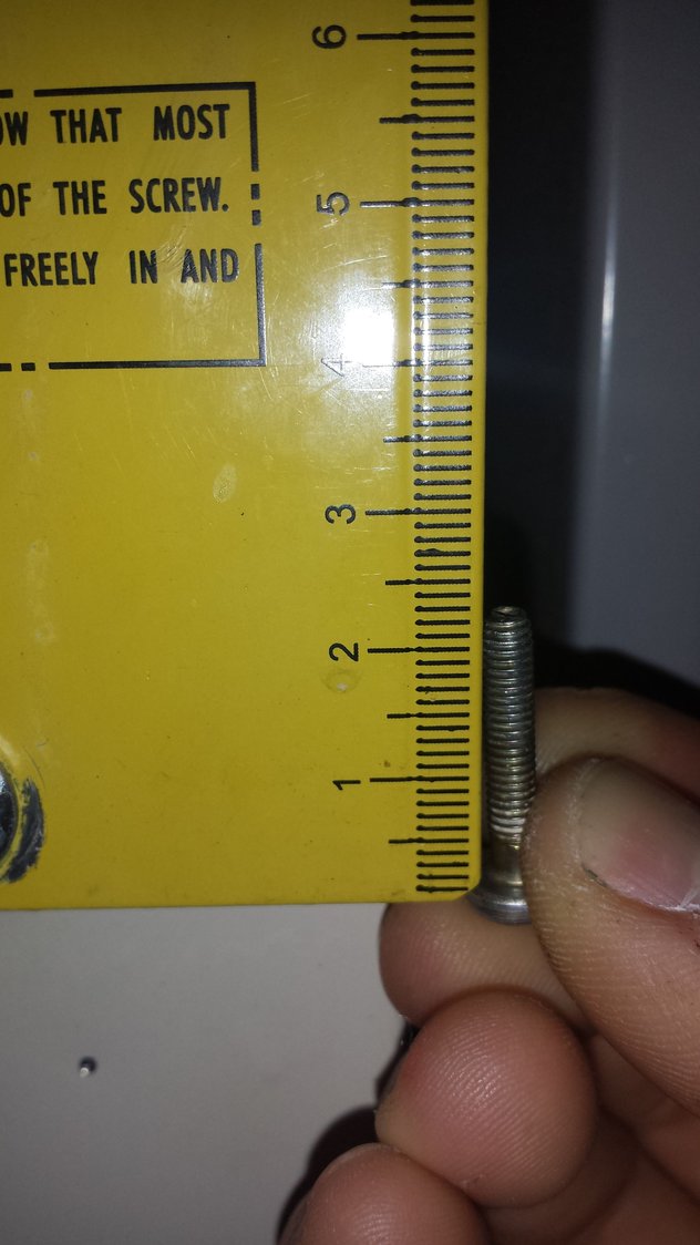

Here you go I helped this guy out awhile back. I have them in mine so I know it works..
https://www.corvetteforum.com/forums...rx-screws.html
I already sent Arthur the info but just for anyone else that needs it. Here is the size. I searched the net and couldn't find anything and that really bugged me so I figured I would just go to ace and measure them up so here you guys go.
So it's metric and it's m4x0.70
Here is a pic of the length in centimeters and the part number for the hex key from ACE hardware..You can also use a Philips head if you want that's what I used when I didn't have the oem screws. Hope this helps someone

Thanks, went to ACE and got some M4 X 70 bolts of the same length and with the same style head. They're hex key, but that may even be better. Good to go now. Of course when I get them 90% installed I'll find the one I dropped.
