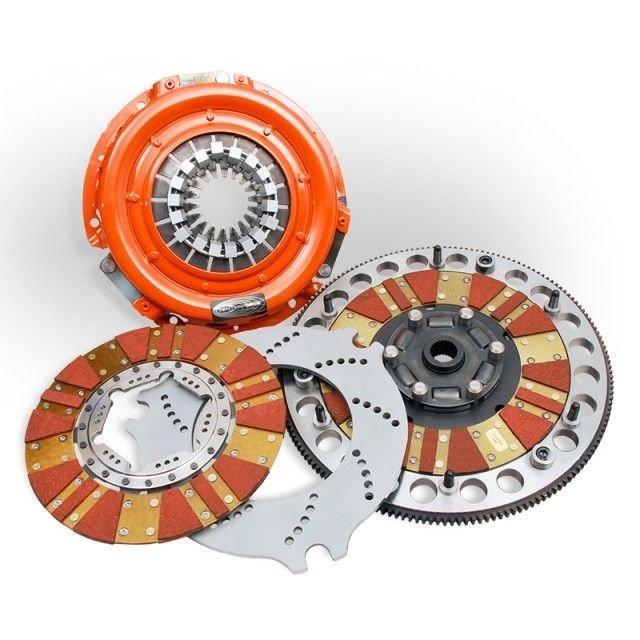

I installed a Centerforce DYAD in my C5 last year that I had purchased from LG. It only occasionally chatters on engagement and for the capacity they claim it will hold, it's not bad to drive on the street. The engagement is fairly abrupt, but easy to get used to.
