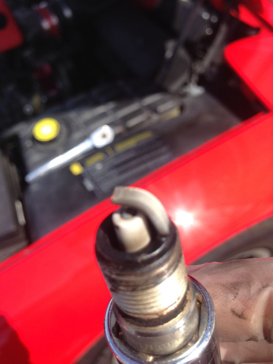

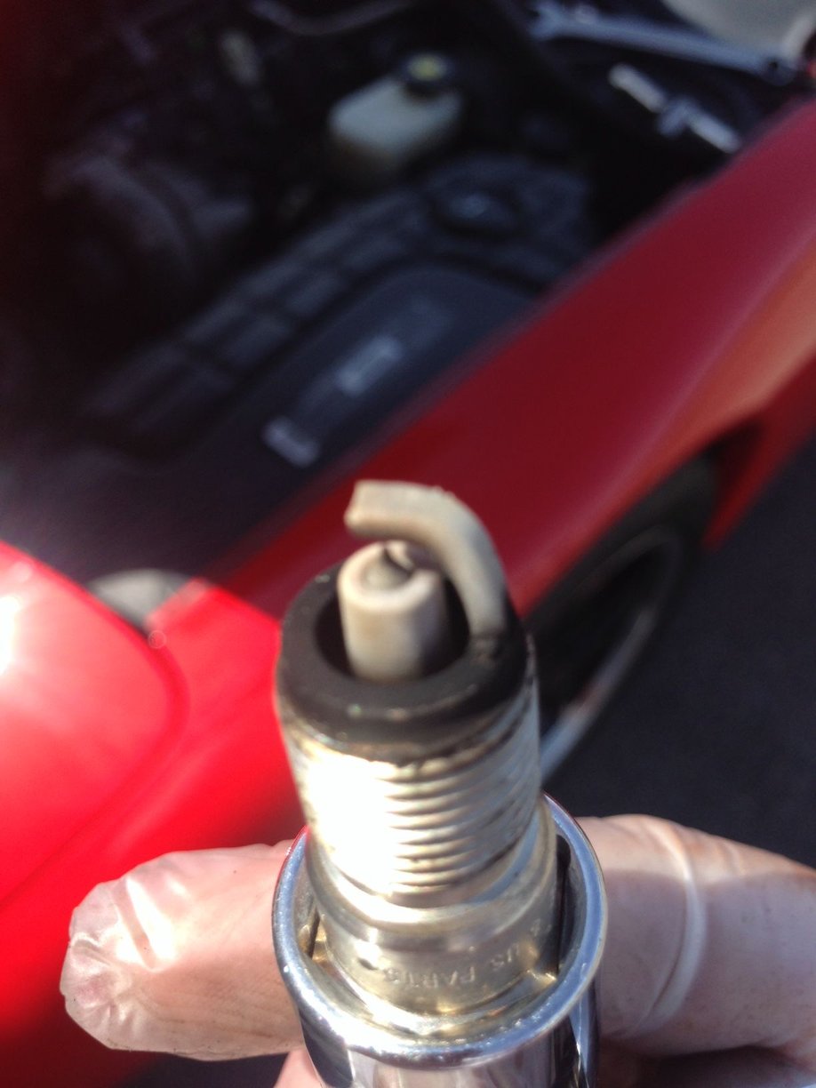

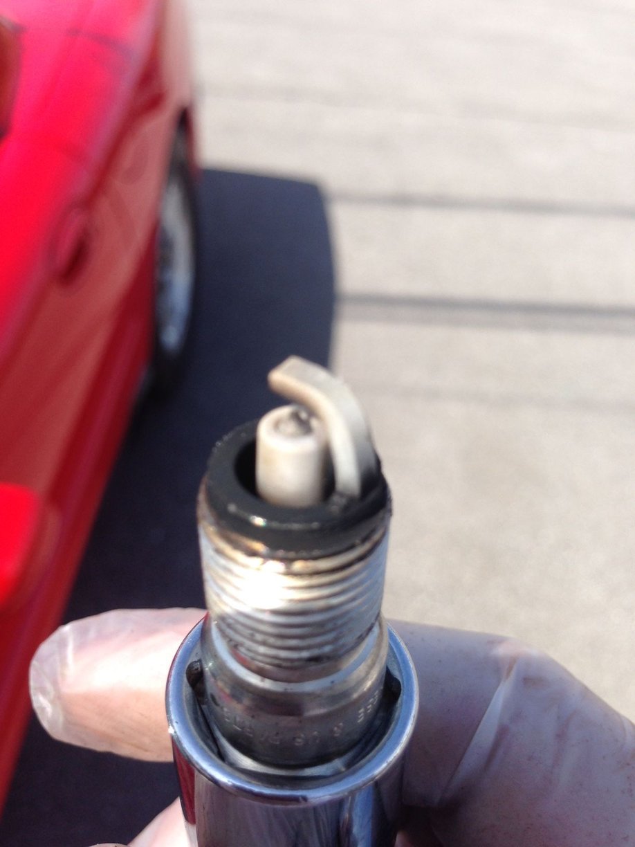

I pulled 4 plugs today can you guys tell me what you think? my camera was dead so sorry for the crappy cellphone pics
plug drivers side front
drivers 2nd back
passenger front
passenger 2nd back

any one?
Old Apr 14, 2015 | 10:38 AM
aaronc7's Avatar
aaronc7
Joined: Nov 2013
Posts: 2,049
Likes: 316
From: USA
lil blurry but looks normal to me
