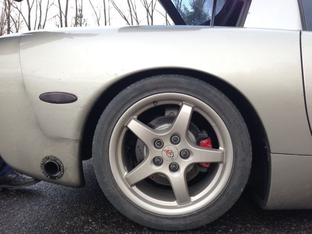

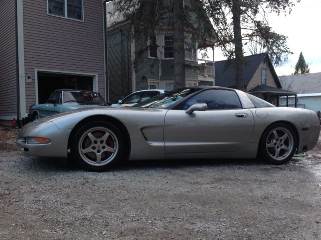

I came across this problem when trying to swap out to c6 z06 shocks - I couldn't even get a jack under the rear puck! So I got it up and was going to adjust the ride height but I'm pretty sure it's all the way up, about 12 threads showing on the adjustment screw. From the pictures you can see how the front is different from the rear. I have a 2000 coupe with FE1 suspension and it has 55000 miles. Is it possible the rear spring is sagging?

In a word ... uh... yea....
Obviously the spring is shot. I see a non-stock exhaust system there too.
These springs can't take a lot of heat. If the springs get hot they will delaminate (come apart).. If your non-stock exhaust system leaked or if it is too close to the springs they can come apart in a hurry.
Generally that's the easiest way to ruin a spring, but they can also be damaged by running over something and damaging the spring (putting a notch in it) and then the spring will eventually fail from fatigue.
Either way it's time for a new spring.

Well it was definitely the spring, you can see the cracks in the fiberglass.
