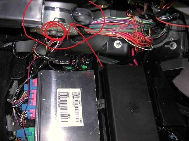

Hello, this component under my glove box is leaking, but I don't know what it is called, and thought one of you guys probably do. I know the issue is probably related to the A/C drainage line, which I just cleaned out. Poked, prodded, and vacuumed the rubber elbow piece and tons of water flooded out, so I thought it was fixed, however this piece is still dripping water.
Thanks

that is your hvac blower motor the water backed up when the ac drain was plugged and is now leaking out of the bottom of the blower motor.

Originally Posted by 8VETTE7
Perhaps there is still more blockage in the bottom of the evap pan that is keeping some water from draining.
Also if the AC line was pluggd up you should inspect the wiper well rubber udders for blockage. Here is a thread with pics and the wiper well on BOTH sides of the car have these rubber udders:
http://forums.corvetteforum.com/c5-t...ak-checks.html
You'll need to pull the motor and dump the water out. Or just wait for it to all leak out. It won't drain from the motor.
