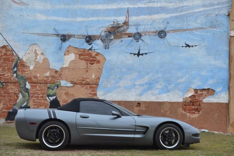

04 coupe lowered on stock bolts, beftore-top after-bottom. Its plenty low for me, any lower and youll have to buy frame savers!

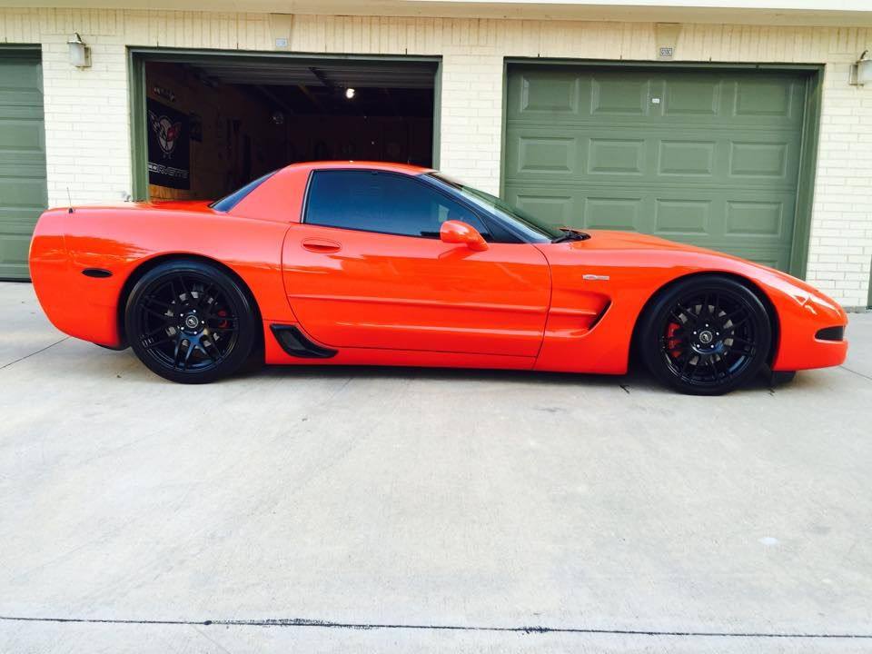

Look at the Zip bolts from Zipcorvette.com This is what it looks like. Rode ok kinda harsh but that's all subjective. You can have a good ride on aftermarket bolts and a shorter shock like the ridetech shock or Bilstein sports.

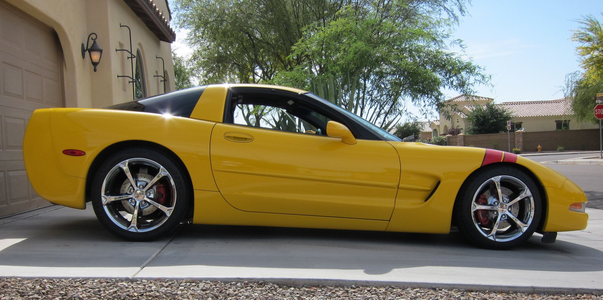

I went with the after market lowering bolts for the front because it was uneven with the stock ones. The driver side barely lowered 1/4 inch even all the way down with the stock bolts.
Mine is not as low in the front as zdeckich (red FRC) but lower than VengeanceVette's (blue).
I did not notice any difference in the ride quality before or after besides the difference in rake. The stance looks 100% better. I'm a little OCD and wanted a nice even space between the tire and well all the way around.
One thing to note, you will need to be extra careful over speed bumps or bumps and dips in the road. I scrape my front air dams all the time.
I'll try to post up a pic later............(OK, it's later)

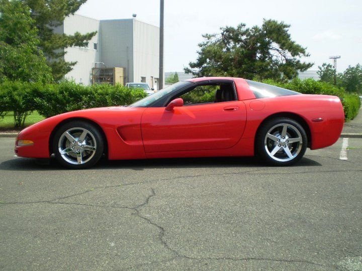

Lowered with stock bolts...front bolt bushings cut down
BEFORE
AFTER
