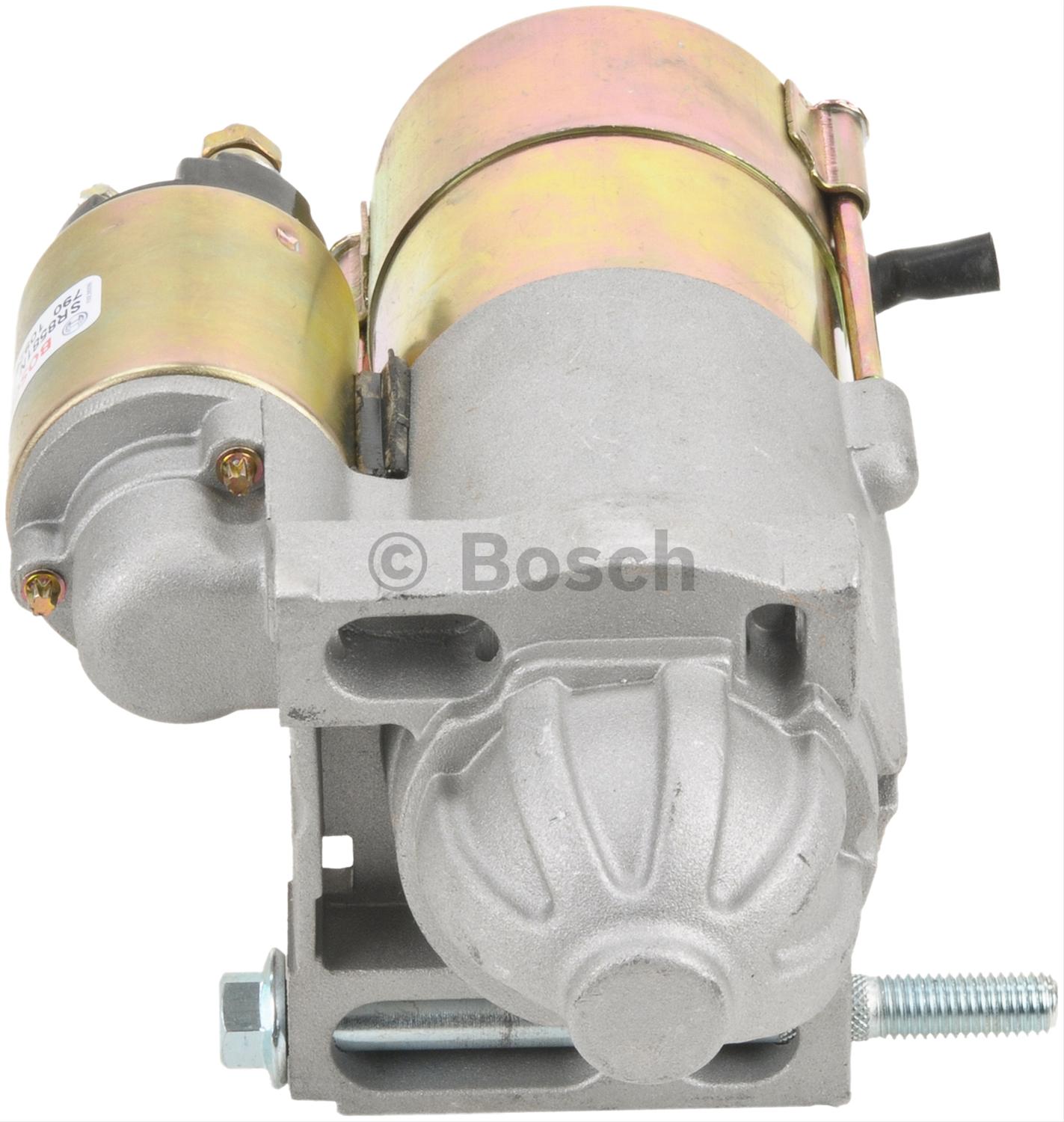

Btw, that "glamour shot" (yes, that's what they're called) of the Bosch starter used by Amazon, is NOT an SR8581N, but rather a generic original style LS starter. IOW, a "stock" photo. Here's what it ACTUALLY looks like:
Btw, anyone notice anything strange about that long bolt that comes with the starter?

It has a textured grip surface on next to the edge of the threads. Can't say I've seen that before. At least that's what I noticed which was odd to me.

Well, no the knurling on a portion of starter bolt shanks is actually very common. What's funny about the bolt is, it's inserted into the starter the wrong way.
Not a huge deal, but still funny. Probably the result of some little eager beaver production assistant at the studio that day when the product photos were being made.

I would not have noticed that.
