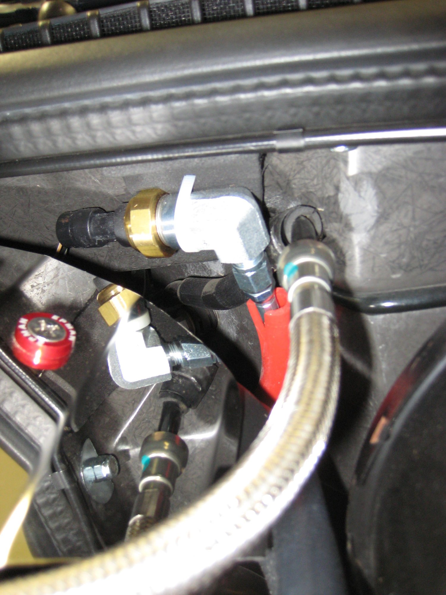

I will be curious to see how long mine lasts, also if relocating it stops the failure or slows it down ??? After spending a lot of time on this forum I decided to re-locate mine when I changed intakes. The way I mounted mine gives me an easy look to see leakage or to change if fails !!!!!! I bought mine at Advance Auto and has the brass lower housing.

Didn't get as many replies as I'd hoped for when I did the thread on the relocation... but, I don't think there was ONE single person that had done the RELOCATE that had a failure...

Sorry I got the sending unit from Summit not Advance Auto !!!!! Also I used a post from here for the parts but I modified it for my purpose. I used a 90 degree fitting from the original sending unit spot because I wanted mine (the hose) to go under the other stuff on the firewall. I also used the fitting from Amazon to just use one fitting. (the sender fits in this fitting) This setup cost me about 80 dollars but I used less fittings which I figured less chance to leak. (to me a nice neat install)
Amazon 14.33
Summit 17.97
Summit 37.97
Summit 6.75
If you deduct the sending unit (you have to buy anyway) this will cost about 42.00

Old May 17, 2015 | 07:48 PM
IRON MAIDEN's Avatar
IRON MAIDEN
Joined: Aug 2009
Posts: 2,785
Likes: 8
From: Sacramento California
Old May 17, 2015 | 07:53 PM
IRON MAIDEN
Joined: Aug 2009
Posts: 2,785
Likes: 8
May as well toss this on while I'm relocating.

That's been my observation over the years on this issue too. If there ARE failures eventually, at least it apparently greatly reduces them.
I was using the braided-line version for a few years, but kept an eye out for a TPE unit someone was selling. I finally got hold of one, and just recently (about 2 months ago) mounted it up. Slick setup. It's the way the factory should have done to been with.

sorry forgot a part it's been a while Atm-2268 from Summit 12.00
