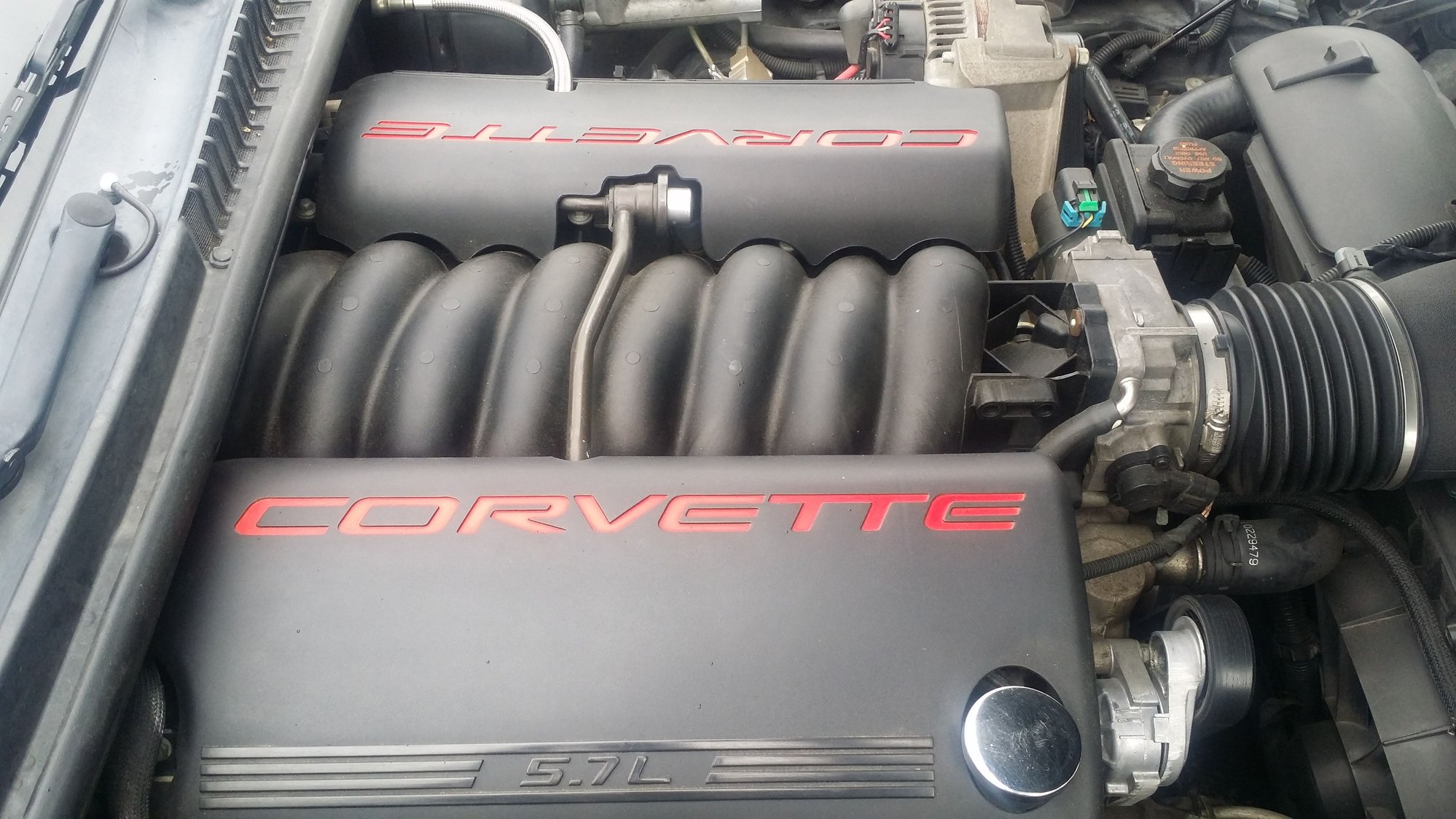

Is this ls6 or ls1 intake?

It's a 2000 so I know it's suppose to be a ls1 intake but I don't see an egr spot like my old one, thanks!

My '99 is the same. C5 LS1s did not get EGR.

Darn lol thanks, I had a 99 trans am and it did so I was wondering

If you take of the passenger side fuel rail cover there is a part number on the manifold that can confirm which one it is.
The most common C5 '97-'00 manifold is 12556333
The most common C5 '01-'02 manifold is 12561182
The most common C5 '03-'04 manifold is 12573572
